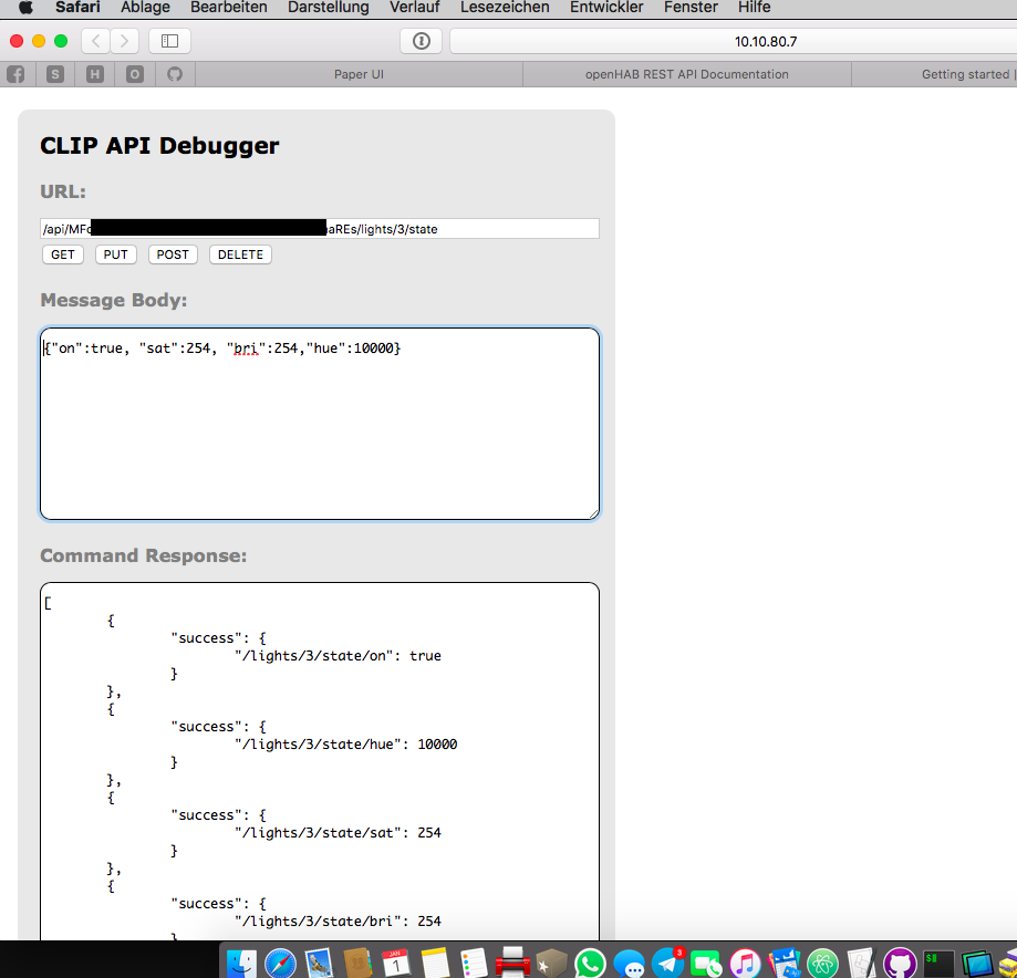

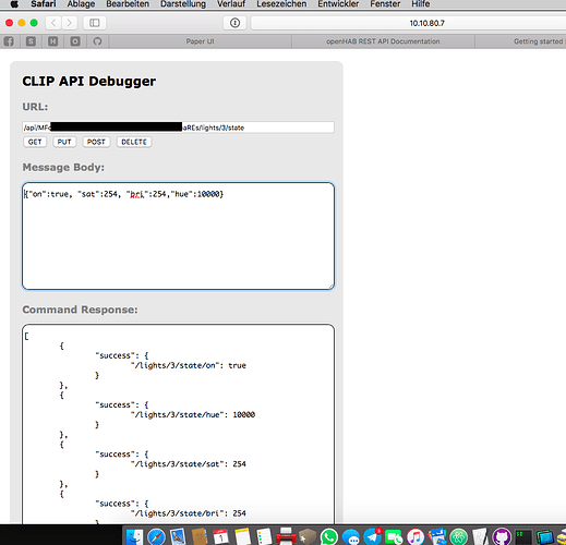

If I control it via a REST call (Hue API) it works fine as well…

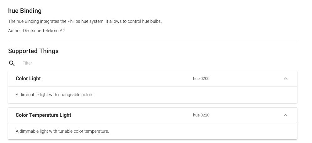

I think that is the Problem … because the IKEA RGB Bulb is a 220 and not a 200 Bulb …
I don’t know where is the Bug … Binding, Phillips HUE Gateway or at least the Ikea Firmware.
That good to know … because I have the same Bulb :wink:
Where is the difference? I tried 220 but then it is not working at all…
No change by yourself won’t work. I think the Ikea Firmware do something wrong and announce the Bulb as 200 instead of 220.
The Difference is that 200 is only a RGB Bulb and 220 is a RGB Bulb and Temperatures Bulb in one Device.

I have checked the HUE API Call … the Color won’t change , only the brightness work for me.

Have you sent a PUT request? It doesn’t work via GET…
I used PHP to send the request and it worked fine.
The Command is send … but the Color don’t change

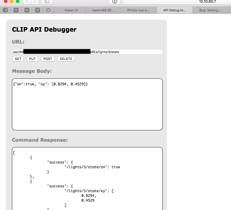

Hmmmm… you didn’t set the color mode, maybe this is the problem of the OpenHAB binding as well…
The Hue bulbs have two color modes: XY and CIE (Hue, Saturation, and brightness). I used the XY values in my PHP framework…
If the color mode is set to XY the bulb doesn’t accept CIE values and vice versa (if I remember correctly)
I guess OpenHAB sends CIE values but if the bulb is set to XY it probably doesn’t work… to work correctly you have to set the color mode first
It is working. I guess the binding does not support the color mode XY.
You’re right… But I guess it’s a problem of hue and/or Tradfri. I tried the HS (CIE) mode and it’s seem to be not working. Only XY mode… And I guess openHAB is using HS, and that’s why it is not working with Tradfri lamps…
But well, just a theory…

I think the Tradfri Bulbs only support XY not hs…
The Phillips Bulbs support both.
The Binding only hs.
