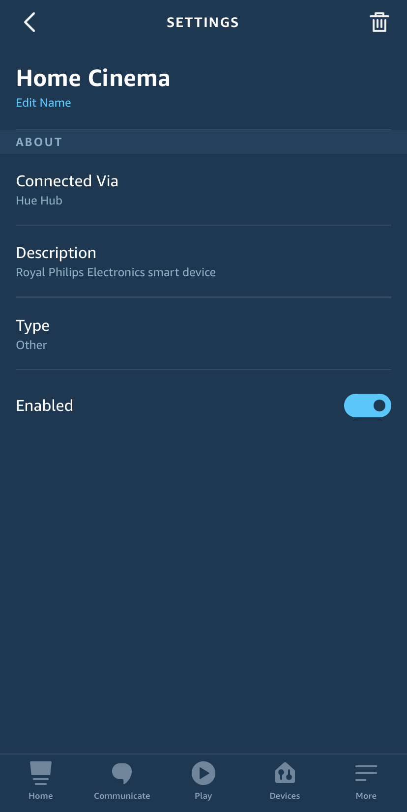

Alexa CAN find devices when it searches for them but cannot control them „Device is not responding“
I also noticed that Alexa finds devices where I have removed the „Lightning“ and „Switchable“ tags some days ago. Seems something is not updating somewhere?

So after several frustrating days I got this solved.
First off all I added the „Lightning“ and „Switchable“ tags in the Lightning type together. This was mentioned in the docu. However this did not solve my issue that I could not control the items with Alexa.

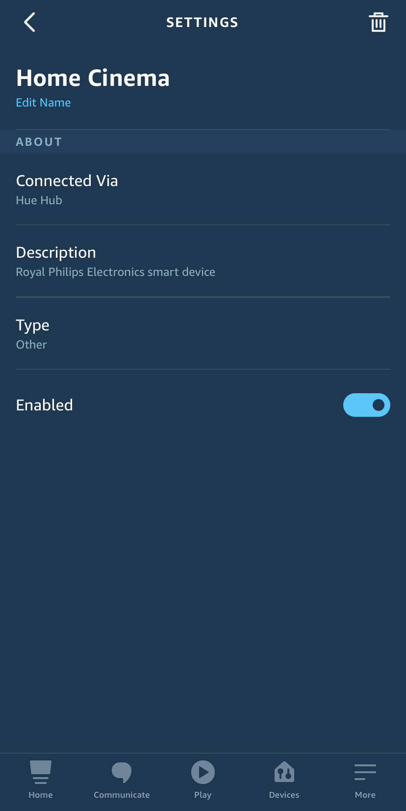

Even worse, now Alexa found all my items two times, once as Various Device and once as Hue Bulb.
The solution to this problem was to not use the Alexa app to find devices but ask an Echo for it „Alexa find new devices“. Also this only worked on the second Echo device. Else the old items would always show up in the Alexa app.
