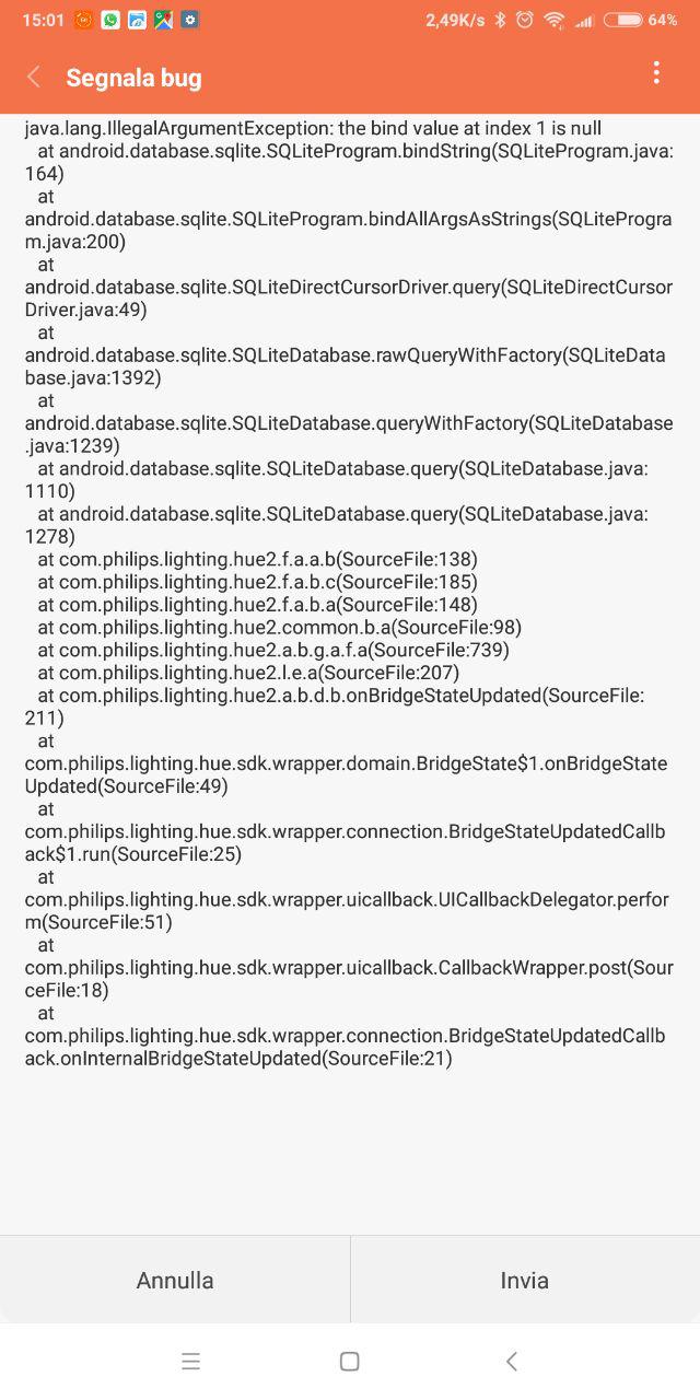

When i try to add the emulated bridge to the Hue Philips Android App,
  • if is not in pairing-mode in openHAB, Philips App ask the pairing button.
  • if is in pairing mode, “A new bridge found!” and instantly crash: screenshot
    There are two Hue Philips app on Android, the same behiavour on both.
openHAB2 just downloaded and installed on a Raspberry.
There isn’t any relevant lines in events.log or openhab.lob
My /api/discovery.xml is empty:
{"lights":{}}
but i have two working lights in openHAB → Paper UI → Control (KNX switch)
It’s normal?
My /api/description.xml : <root xmlns="urn:schemas-upnp-org:device-1-0"><specVersion><major>1</major> - Pastebin.com
Any suggestion about what i can try? Thanks.
Ok i now have /api/discovery.xml not empty, just discovered the tags ‘Lighting’. But the crash occur anyway when adding the bridge to Philips Hue App
