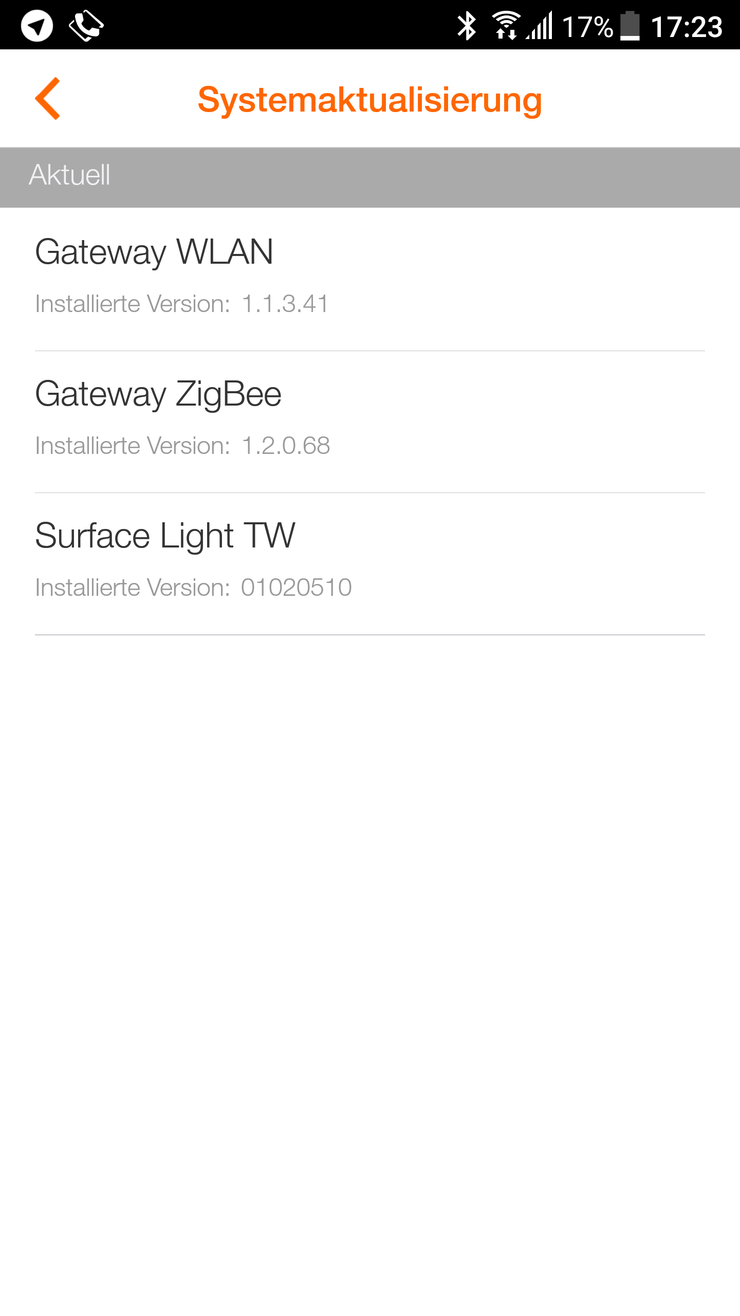

I even need to remove the gateway from the wall socket afterwards. Here are the versions:

That’s a strange one. I’d have expected an exception between the “Connector died” and the first “at…” at least. Can you post a 10s worth of log at TRACE (one poll’s worth of state query) and then a full start-to-dead log at DEBUG?
