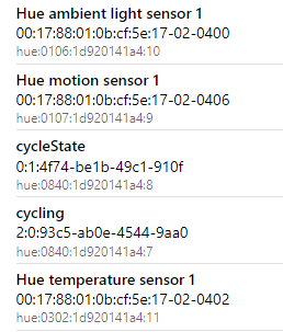

I just added my first Hue Motion sensor
I use OH 3.2.0.M4.
After discovery openhab detects 5 items (see below). Is this correct?
I was expecting only the motion sensor 1
