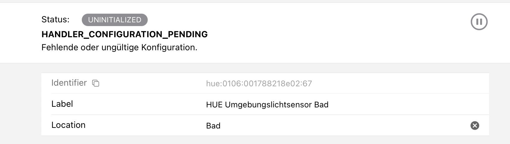

Since update from openHAB 3.2 to openHAB 3.3-M1 I have a error message for my hue Motion Sensors. These sensors also include a light sensor, that stopped working. See screen shot.
Any idea how this can be fixed again?
Is there a bug in the binding?

The lightsensor included in a Hue motion sensor suffers from a bug in that latest milestone. A fix already has been merged. I posted a workaround in the related issue on GitHub.
No, unfortunately not. They are still in review. I hope they will be merged soon.
So I will wait for the next milestone release to get this fixed.
Still a problem om M3.
Fix is to just delet the item an re-include.
Must be done after each OH restart.
This problem had already been fixed in M2.
Removing the sensor and adding it again should work and cure the problem. At least in my setup it is ok again. There is NO necessity to delete and re-include after every OH restart.
Just tested a restart on M3.
You are right, It’s OK now.
Reason I thought it was still a problem was that the Ambient Light Sensor was Online on M1 and went Offline with the Config error when I upgraded to M3. Had to removed and re-included and now it survives reboots.
