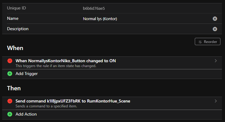

I have been searching my heart out, but I can’t seem to figure out if it’s possible. So in each room, we have 4 different buttons for 4 different scenes, which leads to more than 50 rules just for the scenes. For example 1 scene rule:
First of all, is this causing any performance hit? I’ve moved from using OpenHAB 2.5 with Node-Red to combine it all in OpenHab 3.2 and I feel like it’s just a tiny bit slower now.
Second, I’m currently having a brightness of a room follow a dimmer button, so if the dimmer is set to 57% this is forwarded to the room using follow. It works beautifully. So I’m now investigating, if I can somehow use a follow transformation profile for the buttons to their respective scenes in hue?
Eg. the profile should, instead of ON => ON, send ON => k1lBjpxUFZ3FbRK. Is this possible, so I can remove the majority of all my rules?
I have been looking at this, but that would just lead to the same amount of profiles instead of rules. Are “transformations” the correct path for me to dig into? Or are rules the correct approach?
PS. everything is done in the UI.
Hopefully someone can point me in the right direction. Thanks!

I bet Rules are the best approach but you would benefit from taking the next step from creating simple codeless rules in the UI and move up to Script Actions. You could probably do it all in one rule instead of the 50.

I have considered this using switch case in Java – is this what you are referring to? So one would need to add all the buttons to the trigger and then in the javascript filter on event.itemName?

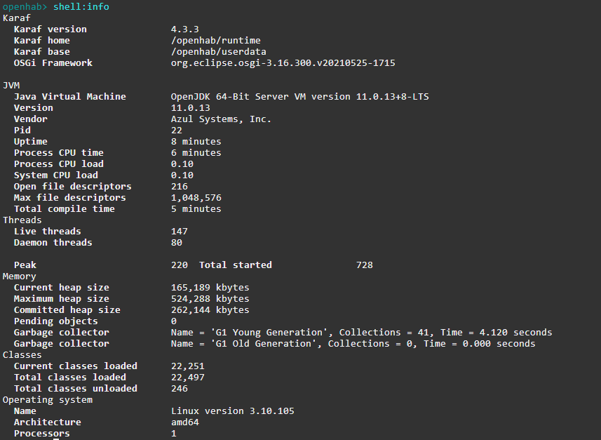

I have been playing around using Xms256m and Xmx512m (running in Docker on a Synology), but from the very limited testing I have done so far, I only see a memory increase and not really a performance increase. Would memory increase theoretically mean better performance/less garbage collection?
After 10 minutes of uptime:
Current Memory usage on container is 600MB. Before setting Xms and Xmx using no JAVA_OPTS, that was around 170-200MB.
Something like that but you could be more clever than that depending on which language you want to write the script action in and how clever you want to get. Other options are included at Design Pattern: Encoding and Accessing Values in Rules though note that’s an old tutorial I’ve not updated yet and not all those options are available in the UI.
I would probably use the Item name approach or the Item Metadata approach.
What I meant was having 50 rules would require a tiny, perhaps unmeasurable, more RAM than having just the one rule. In other words, there is no meaningful performance impact to having the 50 rules.
The default Xms and Xmx settings are fine. And I think the Xmx setting causes Java to go out and grab that amount of memory when it starts up.
Thank you! I have found that individual rules are the most convenient and reliable, and to be fair, good performance. Dropping the Xms and Xmx adjustments also seem to have made a slight difference, but with absolutely no proof :smile:
