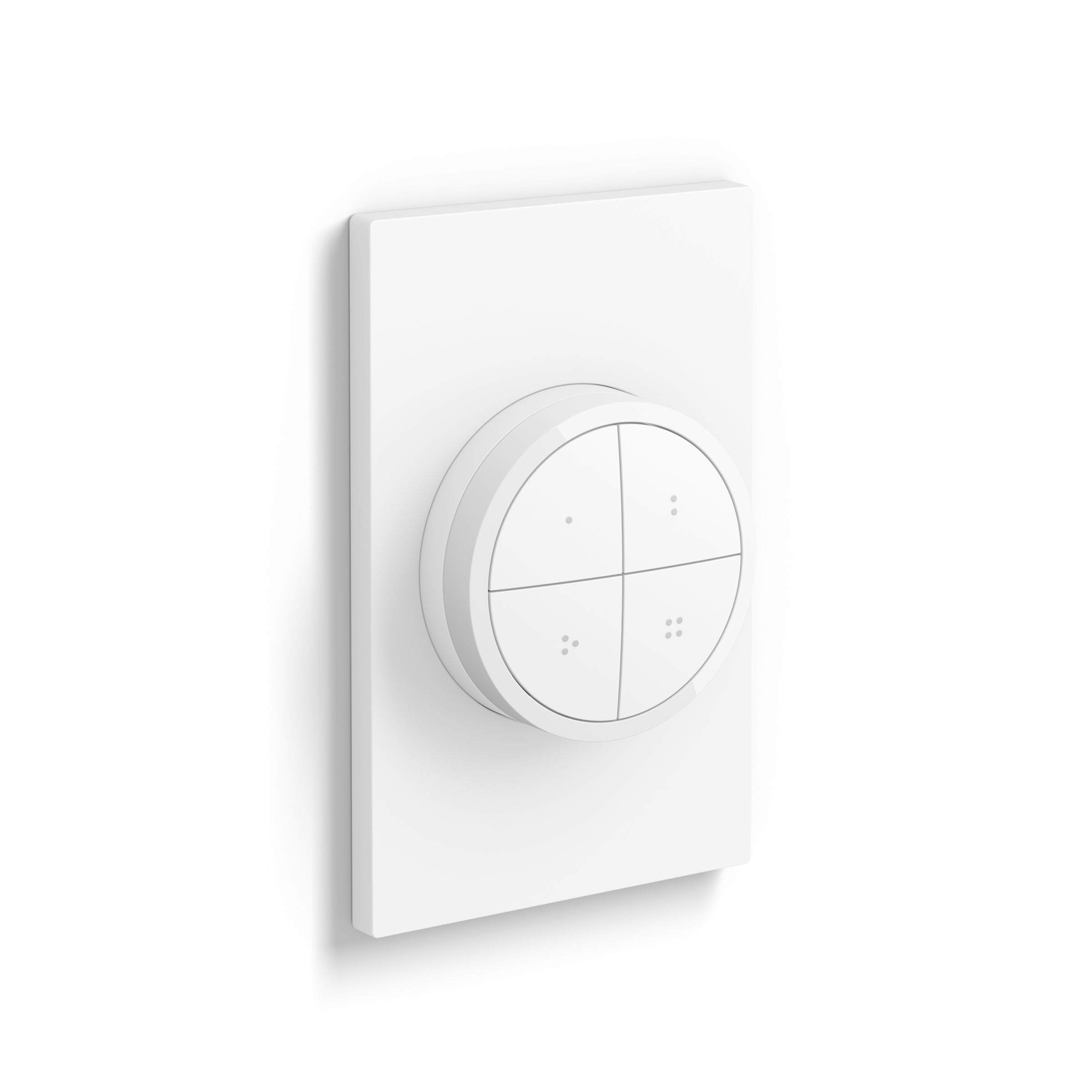

Hi !
I bought one of the new Philips Tab Dial Switches
https://www.philips-hue.com/en-us/p/hue-tap-dial-switch/046677578800
The integration of the four buttons in openHAB has worked well and equivalent to a normal dimmer switch (Dimmer Switch State channel goes 1002,2002, etc.)
Unfortunately, I do not manage to integrate the status of the rotating ring in openHAB. By default, there is no channel in which the rotation information is transmitted to openHAB.
Does anyone know this problem, has a solution or at least a workaround?
Best regards Michael
