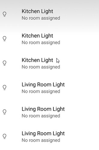

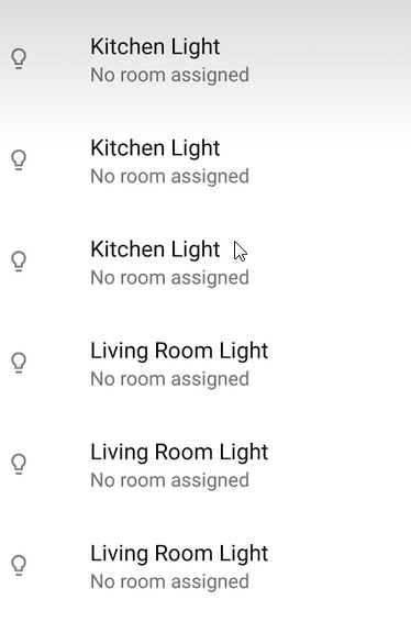

I now have triplicate items in the app.
What is going on here?
Every time i wipe those specific files mentioned above and redo it, it adds another entire new set on the app when i unlink and relink hue…I no have 112 when i should have like 25.
Can anyone tell me how to reset all of this cleanly?
Ok, so every time you clear this, you need to reboot ALL your GHome units…in my case 3.
All triplicate items have been removed from my App
