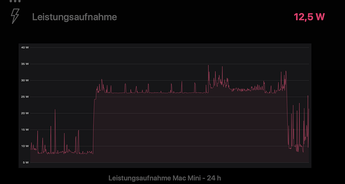

I created a System Widget with Habpanel to monitor my setup. I measure the power consumption as well as the CPU load. I recognized that pretty often my power consumption doubles or even more although the macmini is “only” running openhab and teamviewer for maintenance reasons. i opened the activity monitor to see what’s going on and java proces wass at 150% cpu load for hours until i decided to restart the system.
Unfortunately i have no clue how i could identify the problem - maybe it’s a faulty binding (i only installed the sony devices binding manually) or what else could be responsible …
Now i have the issue again.
Power consumption from 12,5 W (yesterday after restart) up to 27,5 W right now.
Java is going crazy in the system activity monitor.
I tried upgrading to the Milestone 3 and latest Zulu8 and still got this issue …
Can someone poke me in the right direction on what to investigate?
Thank you!
