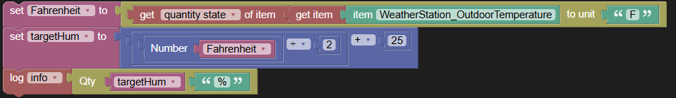

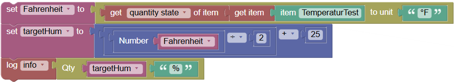

It works here when a variable is used for converting to a number.
But I also find the inline transformation more elegant.
It didn’t occur to me to come at converting it from the other direction. That makes the Blockly much more reasonable.

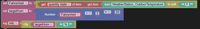

I created a rule named HumidityTarget using your example and using my Outside Temperature Item
and got an error in the event log.
 Script execution of rule with UID 'HumidityTarget' failed: org.graalvm.polyglot.PolyglotException: Error: Failed to create QuantityType from NaN%: java.lang.NumberFormatException: Invalid BigDecimal value: NaN%
It wasn’t clear whether I should create a typed variable or non-typed but I chose non-typed.
I will add more logging to see where it’s failing.

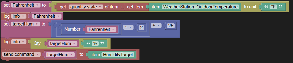

I got it working!
I had not put the proper °F units in the rule.
Thanks to everyone who commented…I certainly learned a lot more about Blockly!
I added a line to send the targetHum value to an Item so it gets persisted.
