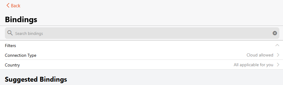

Sadly, this info isn’t accurate. I’ve tried to have this discussion before:
In short, there’s no differentiation between accessing the Internet and using a service that requires registering identifiable information. The information isn’t easily available when you try to figure out what device to buy anyway, as far as I know, the only way to see and filter by this information is by opening the marketplace from within OH. You can even use it for filtering there, but since the categorization doesn’t really differentiate between a binding that merely fetches some public information from the internet and one that must have you sell your soul to give you access, it’s close to useless for me.
It would help if the categorization had an option for “read only Internet”/“no account”, and if this status was clearly shown in the binding documentation when you look up the binding. But, that’s not where we are. Also, frankly, it doesn’t help if the binding never uses the Internet, if you have to register to enable local access.

No, it is implemented, at least I can see it in 5.1.1:
Yes, that’s been there for a while - it was there in 4.x as well. But, as I said, this category doesn’t help much, as it doesn’t capture what is “interesting” - whether your data will be compromised by using the device, and whether it has a “built in kill-switch” in the form of depending on online services that can be killed off at the manufacturer’s whim.
In addition, I think this should be visible in the binding documentation, so you don’t need to actually use OH to look it up at the marketplace to get access to the information.
