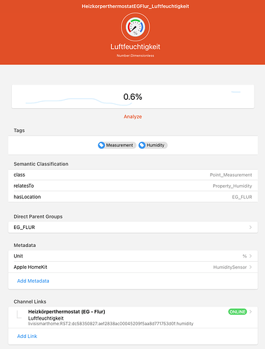

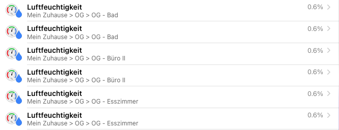

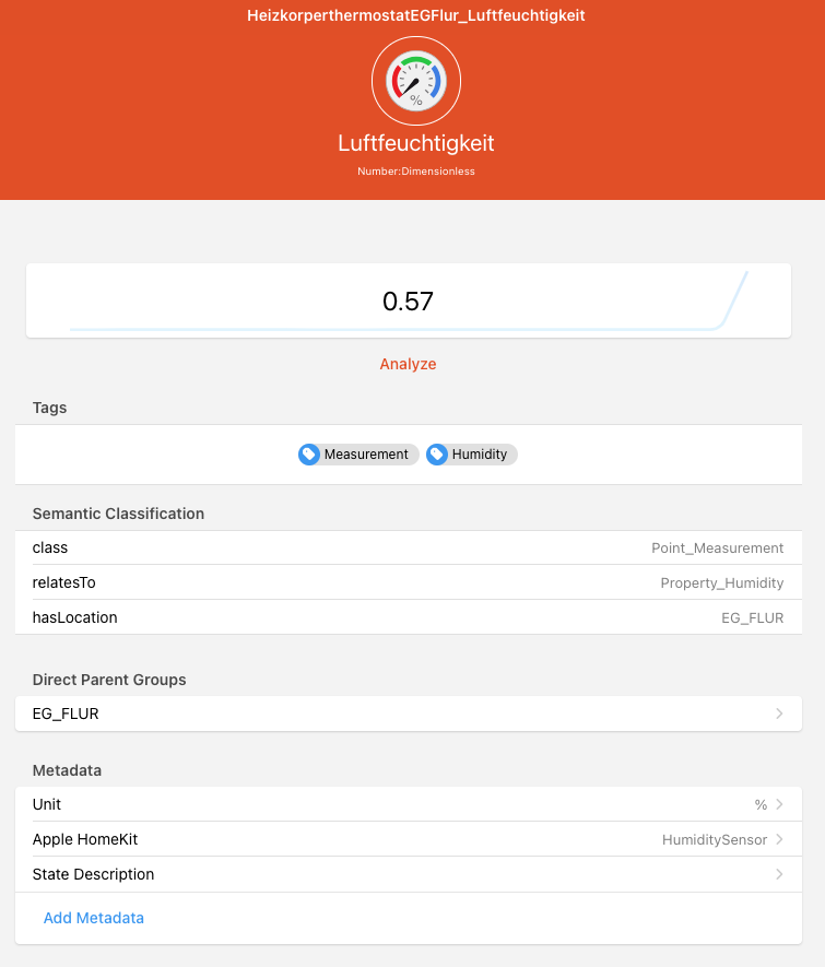

Humidity does not display the value correctly
Since openHAB version 4.1.0 I have the problem that the humidity is no longer displayed correctly. Instead of 60%, it now says 0.6%.
It affects all sensors. Is the problem known?

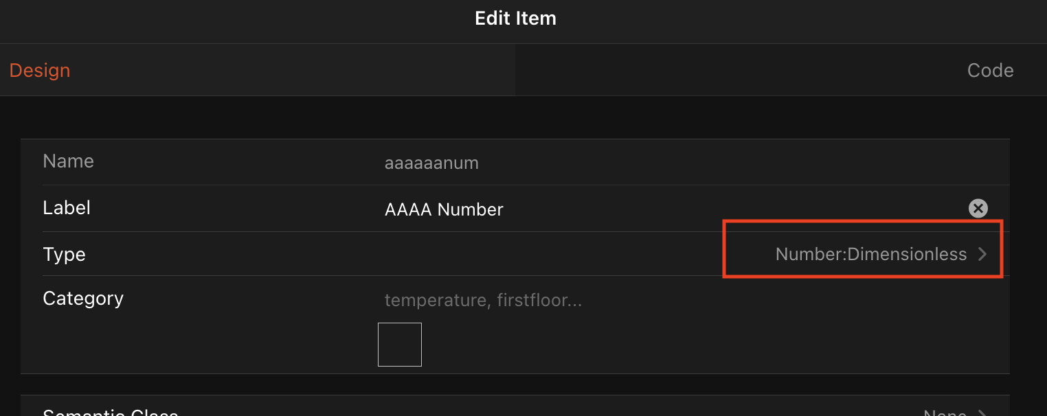

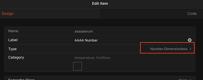

First, make sure the item type is Number:Dimensionless. If not, edit and change it

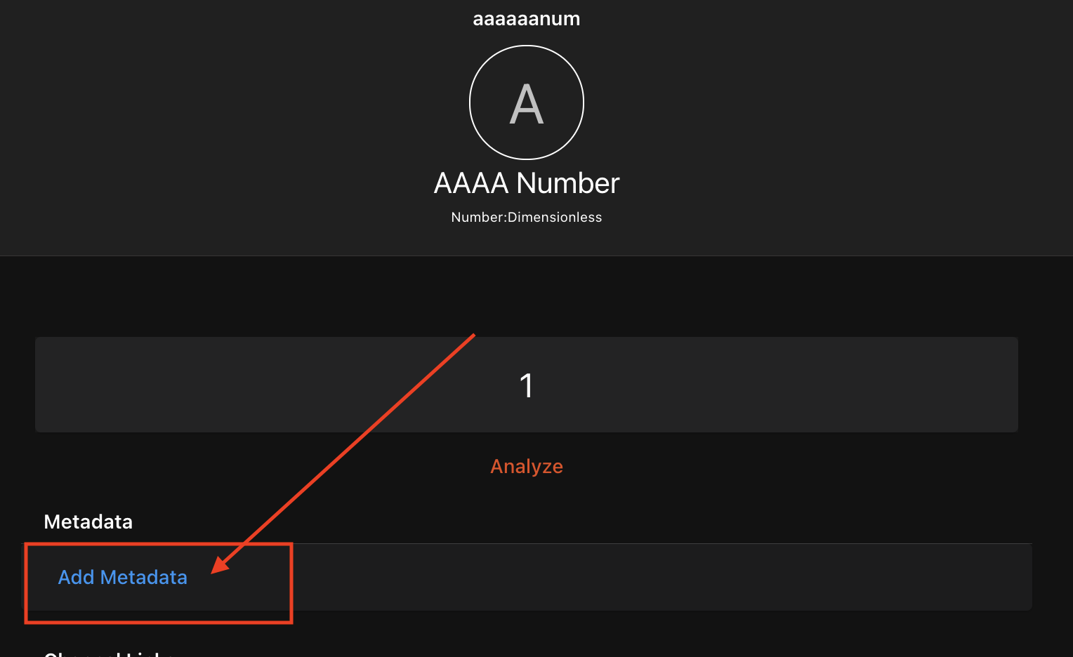

Next, go back out and back in (so the change in the item type takes effect on the browser) then click Add Metadata

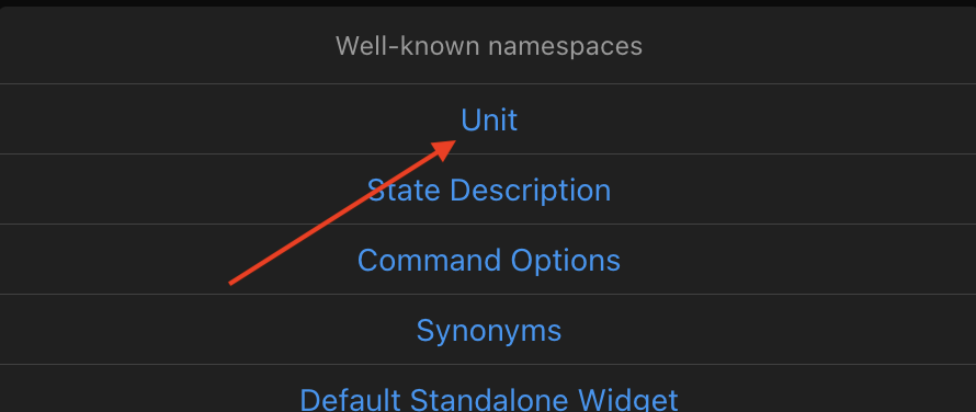

Then click Unit
Then enter % in there.

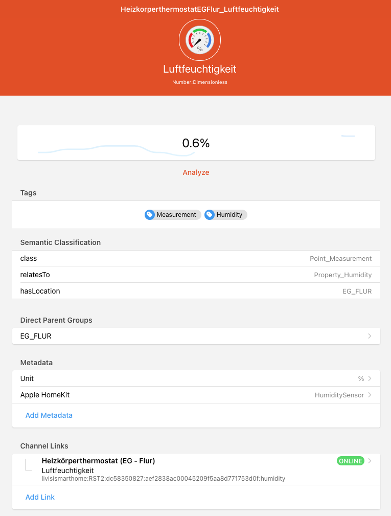

Have made the changes from you, unfortunately without success. It is still displayed 0.6%

@rlkoshak I understand what you mean. Where can I check or see what value the binding “livisi” passes?
Small addition: The problem exists only recently, when I updated to 4.1.0. Before with all versions of 3.* and also with 4.0.2 the values were always correct, without that I had to adjust something.

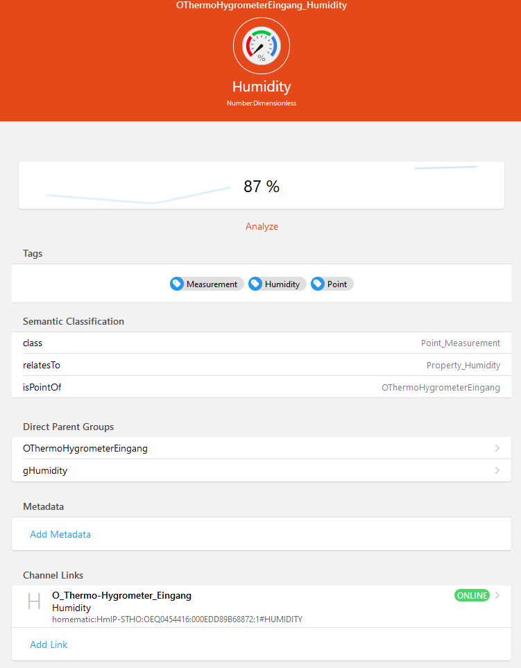

PMFJI I experienced/had the same situation. I do not know exactly with which concrete version of 4.x it happend, as I upgraded unintentionally as some others did (different story), but from my Homematic outdoor thermometer/hygrometer I saw in the logs, that there were values like 0.nn:
2023-09-11 09:59:18.274 [INFO ] [openhab.event.ItemStateUpdatedEvent ] - Item 'OThermoHygrometerEingang_Humidity' updated to 0.87
The item is a number:dimensionless and without a state description it is displayed on the item page as 87%
But going to the analyse page a graph is drawn with values as 0.nn. Same in HABpanel. Adding a state description like %.1f %% I get a value of 88.0% on the item page as expected, but there is no change on the analyse graph or in HABpanel.
I changed the item to a number and it seemed that this made things worse as I then got the 0.87 also on the item page.

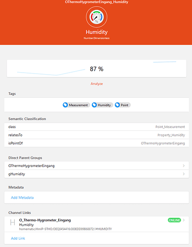

The funny thing was, that I followed your hint to try to change the item to a string. This resulted in a NULL, but getting back to number:dimensionless I got a 8700% value. So I tried number again, saw the 0.87 again for a moment on the item page, but then it switched to 87 the next moment, and the graph now also showed a 87 value and also in the log and in HABpanel everything works fine now, including the use of the state description. It seems that you really have to have a number item, and that you simply have to wait for the next value from the device to see that this works. If you do not wait for the next value it seems that things are still wrong.
Changing the type of an Item does not change the state of the Item. Indeed you have to wait for the next update.
However, no you don’t need a Number. As discussed in the breaking changes for OH 4, the way units are handled has changed significantly. The Item requires unit metadata. Without unit metadata the system default unit is assumed which is ONE for Number:Dimensionless.
Whenever a state update is sent to the Item, if that state update has units, the state update is converted to the units of the Item. In this case, the binding is sending 87 % which gets converted to .87 ONE.
I must admit, it works as Rich says ( in OH 4.1).
Yes, you are right. I did not wait long enough after switching to number:dimensionless when I saw this 8700. With the next value and the unit % as an additional meta data it works, too.
