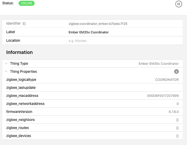

it worked

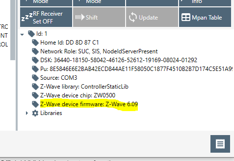

Well… I went and did it anyway
This link suggested a much easier pad on the stick to short and it was still fiddly, but doable.
I now am running a much more current Z-Wave firmware on my HUSBZB-1 stick
