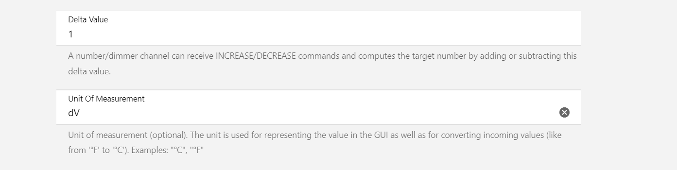

The super easy way to do this is by setting up your Thing channel with unit="dV" (deci Volt), 3500 deci Volt = 350 Volt
Then set your item’s unit to V. Voila!

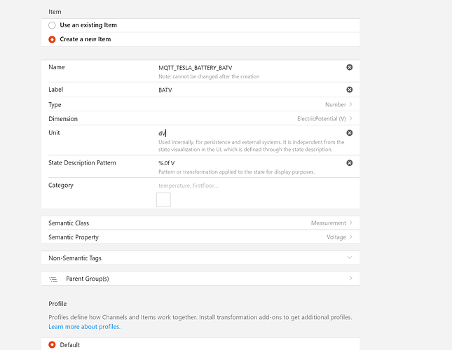

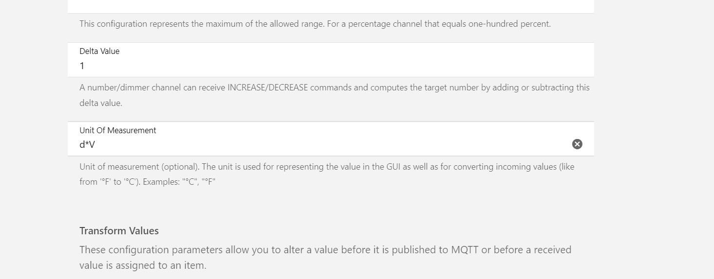

Use unit = "dV"
Maybe you’ll have to write it with an asterisk: unit = "d*V" as DeciVolt isn’t a very common unit .
Link a Number:ElectricPotential Item and set this to unit="V" and State Description Pattern="%.1f V" to get the electric potential with one decimal (350.0 V)
EDIT: deci is abbreviated with D, not d, as d is the abbreviation for day. So it has to be Channel unit="DV"

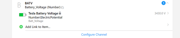

I use dV and d*V but i have the same value now 3410.0V

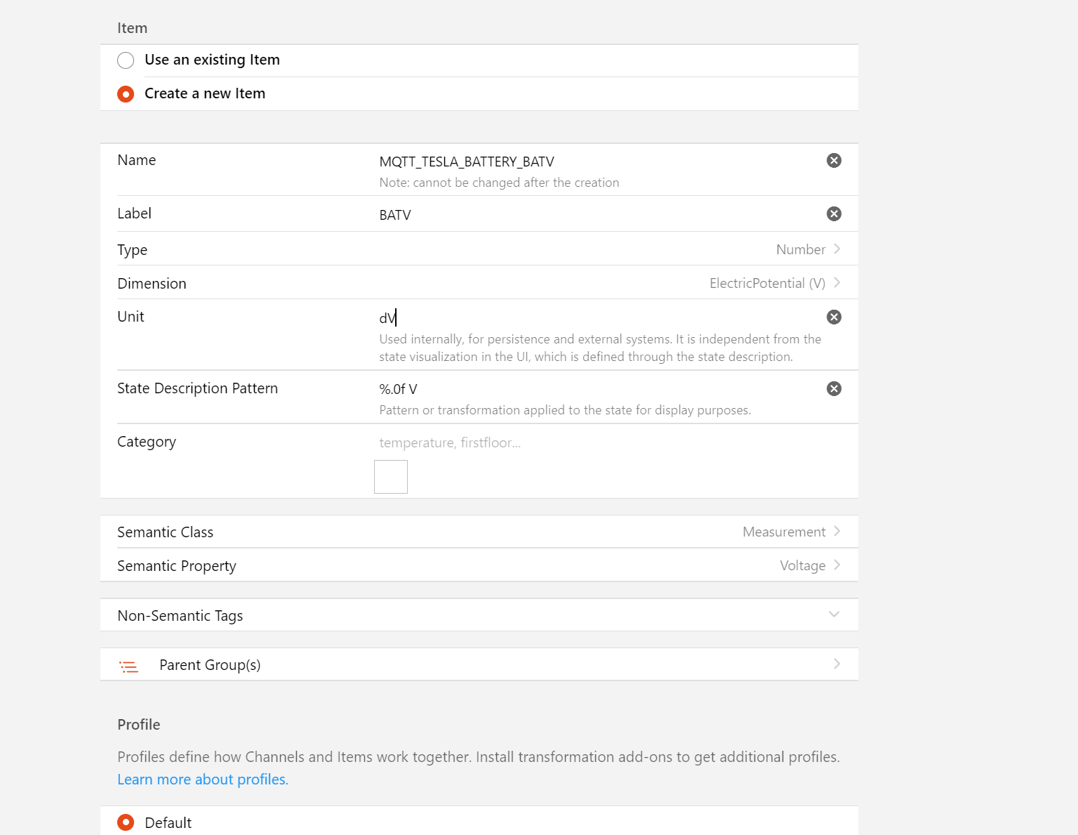

Your item needs to be Number:ElectricPotential and set the unit on the Item to V
As said… You’ll have to use Number:ElectricPotential and you’ll have to set the unit for the Item, too.

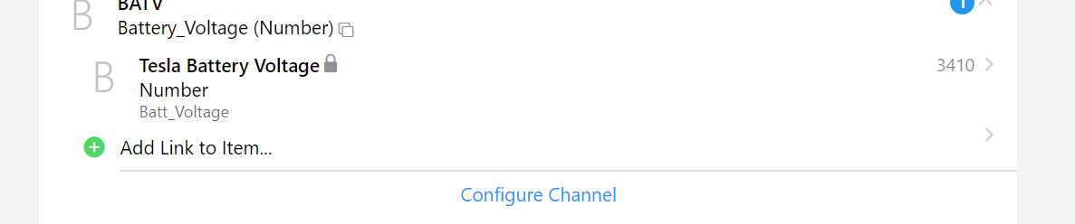

I created new item but now my measurement is NULL
i created an item like this and the value displayed is 3410

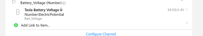

Number:ElectricPotential Batt_Voltage "Tesla Battery Voltage [%d]"

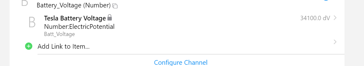

in this way my displayed value is 34100.0
my items:
Number:ElectricPotential Batt_Voltage "Tesla Battery Voltage [%.1f dV]"
my sitemap:
Text item=Batt_Voltage label="Tesla Battery Voltage [%.1f dV]" icon="batterylevel"

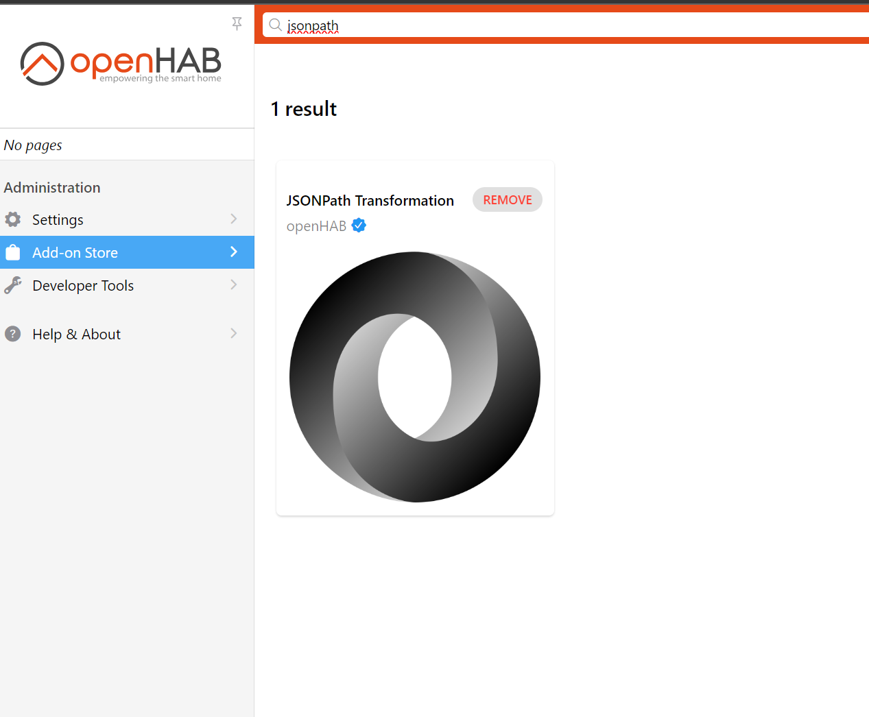

There’s no file to use. What would you put in this file? $.battery_voltage is the path. It’s all JSONPATH needs.
Make sure you’ve installed the JSONPATH add-on.

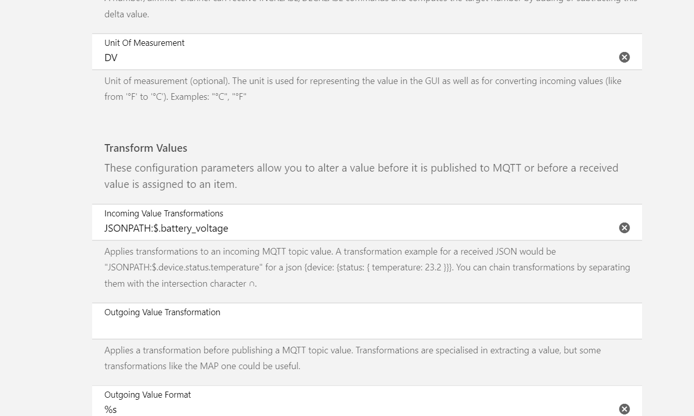

As a thing within a things file:
Bridge mqtt:broker:broker "My broker" [
// broker config
Thing topic tesla "Tesla" {
Channels:
Type number : vBat "battery voltage" [ stateTopic="battery/info", transformationPattern="JSONPATH:$.battery_voltage", unit="DV" ]
Item within an items file:
Number:ElectricPotential TeslaBattery "Tesla Battery" <battery> {channel="mqtt:topic:broker:tesla:vBat", unit="V", stateDescription=""[pattern="%.1f V"]}
Sorry, did a quick test and it’s DV, not dV (as d is already reserved for Day)
Please change Channel unit to DV and Item unit to V.

Did you see my posting? DV instead of dV should do the trick…

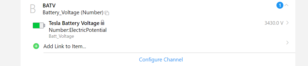

my items:
Number:ElectricPotential Batt_Voltage "Tesla Battery Voltage" <battery> {channel="mqtt:topic:ce2219a49a:6f071898da:Battery_Voltage", unit="V", stateDescription=""[pattern="%.1f V"]}
