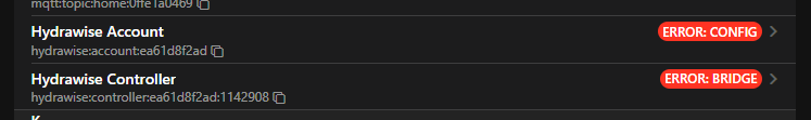

Hydrawise Binding - Bridge Error „unauthorized“
Indeed very easy - sometimes you don’t see what is so obvious :person_facepalming:t2:
Just FYI the fix was merged into main and (just) made into in the 4.1.1 release which is building right now, so if you upgrade, i would remove the binding from the addon so you get the distro version (which is why i don’t use the addon folder for temp fixes like this as i forget to remove them !)

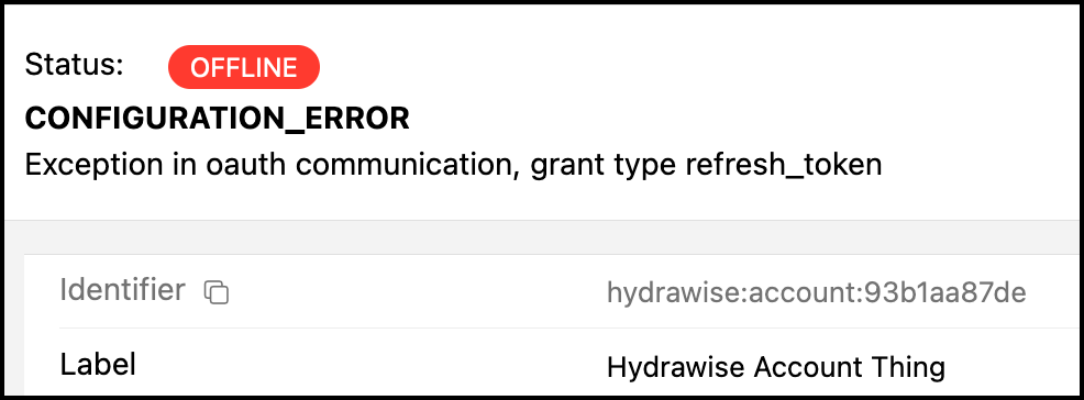

I am running OH 4.1.1 now, and it happened again:
Disable/enable helps to bring it up again.
Anyone else have problems as well?
Yes, I had the same problem yesterday.
I didn’t update yet.
But even with the snapshot I have the same problem:
CONFIGURATION_ERROR
Exception in oauth communication, grant type refresh_token
Seems it is another error.
@WeRo
it is exactly the same error.
See my screenshot above and the error message.
Hydrawise changed something on their end, i’ll take a look at it.
I can confirm this, yesterday with 4.1.1 was everything fine for whole day. Now it’s acting like 4.1.0
disable/enable solve it for couple of hours and then error again.
Yes it’s the same message like yours but it’s different to the first error „configuration_error unauthorized“
