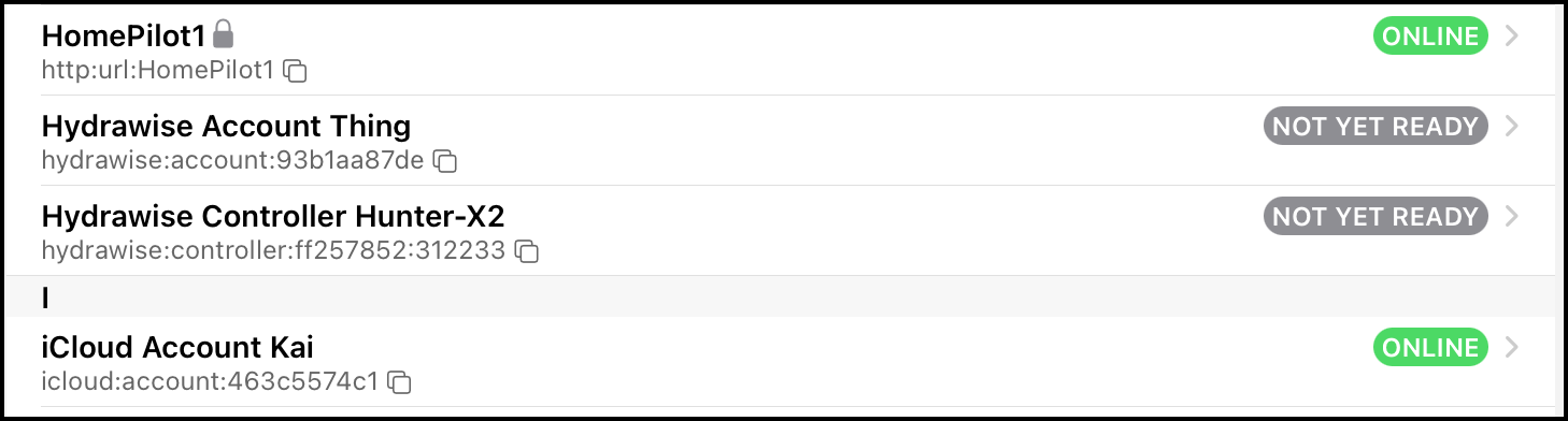

I removed binding, installed the new jar-file to addons folder, rebooted many many times (including deletion of cache- and tmp-folders) but I am unable to get the new binding online:
2024-01-05 18:47:58.113 [INFO ] [ab.event.ThingStatusInfoChangedEvent] - Thing 'hydrawise:account:93b1aa87de' changed from UNINITIALIZED (HANDLER_MISSING_ERROR): Handler factory not found to UNINITIALIZED (NOT_YET_READY)
2024-01-05 18:47:58.117 [INFO ] [ab.event.ThingStatusInfoChangedEvent] - Thing 'hydrawise:controller:ff257852:312233' changed from UNINITIALIZED (HANDLER_MISSING_ERROR): Handler factory not found to UNINITIALIZED (NOT_YET_READY)
at org.openhab.binding.hydrawise.internal.handler.HydrawiseAccountHandler.getServices(HydrawiseAccountHandler.java:129) ~[?:?]
Caused by: java.lang.ClassNotFoundException: org.openhab.core.config.discovery.AbstractThingHandlerDiscoveryService cannot be found by org.openhab.binding.hydrawise_4.2.0.202401051647
