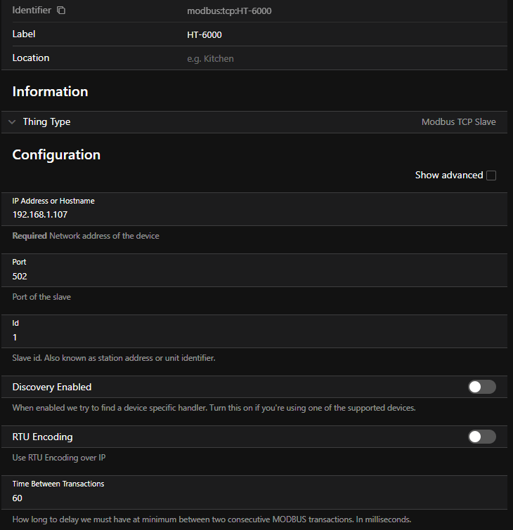

I was able to find the IP address of my PV inverter. I defined the thing coming out of the modbus binding and configured it this way:

I found the problem with item definition. The correct item looks like:
Number SolarPower "Solar Power [%.2f W]" { channel="modbus:tcp:HT-6000:inputRegisters:solarPower:number" }
unfortunately i do not receive any log file on the change of the Solar power value change :frowning:

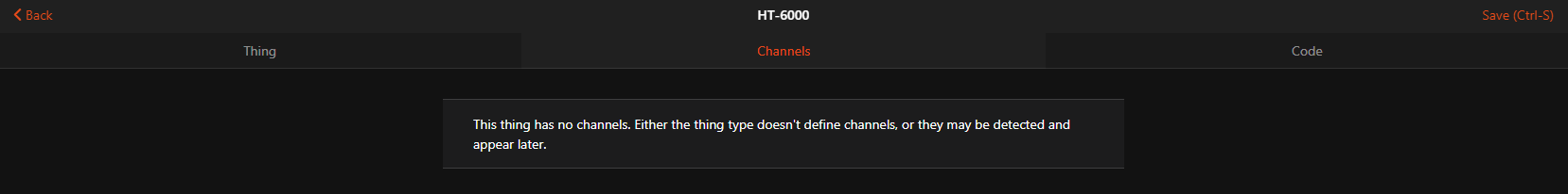

Do I have the right thing chosen? This thing does not provide any channels:
Any help to bring this to alive appreciated!
