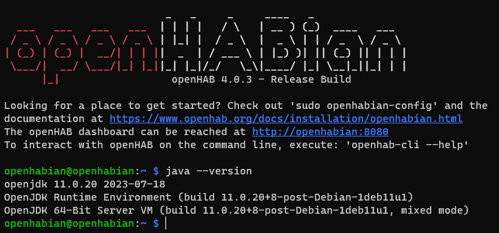

You need Java 17 running OpenHab4:
$ java --version
openjdk 17.0.7 2023-04-18
OpenJDK Runtime Environment (build 17.0.7+7-Raspbian-1deb11u1rpt1)
OpenJDK Client VM (build 17.0.7+7-Raspbian-1deb11u1rpt1, mixed mode, emulated-client)
OpenHab3 was Java 11

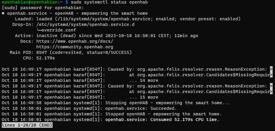

Is it really rebooting the complete system or is it restarting the service / web UI ?
What is content of the openhab.log file ?

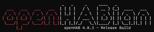

I allready did this and still openhab 4 got installed, the java version was Java 11, so it didnt even start.
I also installed an old release of openhabian ([openHABian v1.7.5] Release openHABian v1.7.5 · openhab/openhabian · GitHub)). But it still installed openhab 4.0.3.

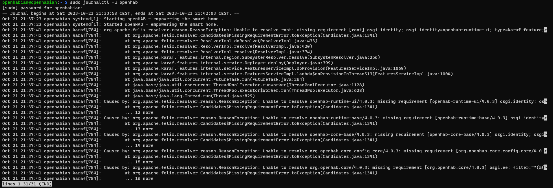

Can you post the logs?
interesting to know would also be the output of
sudo journalctl -u openhab

I did this with the newest openhabian release and also with an older one, the right Java version got installed but the OpenHAB version was still wrong.
And again, i downloaded realease 1.7.5, put
in the config file before the first boot. an openhab 4.0.3 got still installed and doesnt start, because of the wrong java version.
