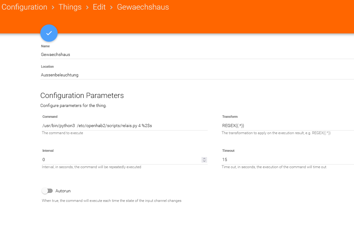

The command that I enter in things works in the terminal, I also wrote the command in the whitelist. The command is:
/usr/bin/python3 /etc/openhab2/scripts/relais.py 4 %2$s

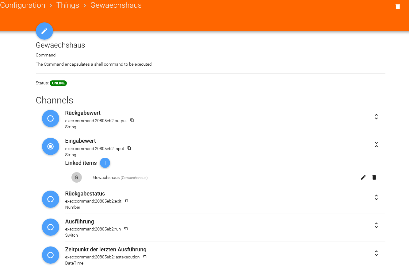

Youâve not shown the Item configs, specifically which Items are linked to which Channels of the Thing. Thatâs particularly important since you are using %2 in the command.

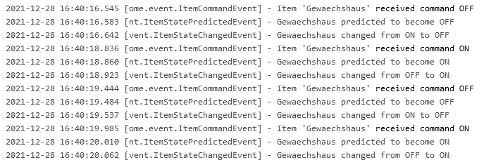

Looking at your events.log
, your Gewaechshaus Item is getting a whole series of ON/OFF commands within seconds. If that has something to do with the rule or the Thing you have shown us, there is also something else at work - another rule perhaps.

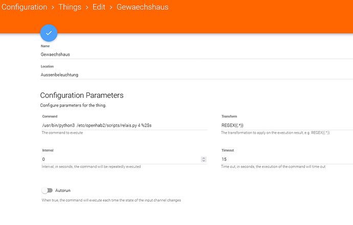

Your Thing has âautorun
â turned off. This means that your script will not be run when you send a command through your Item to the input
channel.
I have activated autorun, but there is no change.

Youâve not linked anything to the Input channel. The %2$s
gets replaced with the contents of the Item linked to that Channel. Typically in a case like this you will send a command to the Item Linked to the Input Channel, which triggers the script to be called.
Note there is also an Output Channel. Link a String Item to that and youâll get the text output by the script.
The Switch Item linked to the Run Channel indicates whether or not the script is running. In this configuration it is not used to trigger the script to run.

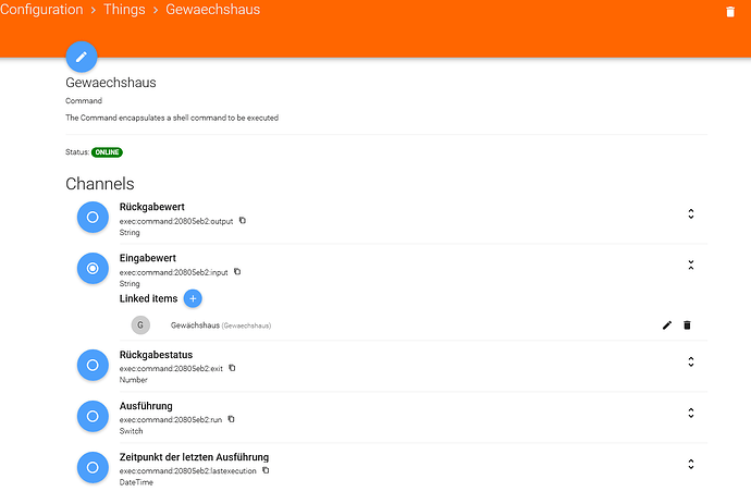

I mean, but I have linked the input channel to the item, isnât that correct?

I think you missed this in the binding docs -
Attention: Linking
input
to any other item type thanString
will result in erroneous behavior. If needed, please use a rule to convert your itemâs state to a string.
Exec binding can be quite clumsy to use. Another limitation of the input channel is that autorun only triggers for commands that are different from the previous.
You might want to keep your Switch type Item, abandon the binding, and instead use a command-triggered rule to run executeCommandLine()
instead.
