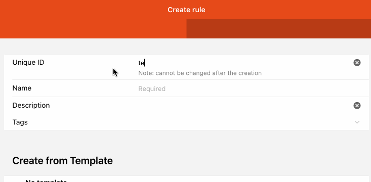

I have trouble with the grayed name field of the rule. It is requried, but not editable.
Crazy…

If you add a new rule without adding trrigger or actions first, are you able to enter the name of the rule?

Can you capture in separate screen shots or as an animated gif the steps you take to create the rule?
Have you tried clicking in the field and entering the name? Keep in mind that the “Required” is always grayed out like that. That doesn’t necessarily mean you cannot click on it an type in the name you want. It’s grayed out not to indicated it cannot be edited, but to indicate that the field has no value. The “Name” is not “Required”.
This looks like a browser issue. Have you tried a different browser? There really is nothing on the server side you can do to make these fields not editable or even clickable. There is no setting, configuration, or anything else like that.
