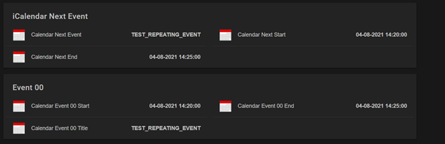

After a few minutes (refresh is 3 min) the icaldar items are updated as expected: (Today the event should start at 14:20)
![image](https://user-images.githubusercontent.com/57780186/128186777-86aa6a00-dac4-4bb1-bf41-d0bcd0bd6831.png)
In the log the event is only listed at 14:20 as expected:
2021-08-04 14:20:00.583 [INFO ] [openhab.event.ItemStateChangedEvent ] - Item 'C_Current_Event_Name' changed from K_C to TEST_REPEATING_EVENT
2021-08-04 14:25:00.354 [INFO ] [openhab.event.ItemStateChangedEvent ] - Item 'C_Current_Event_Name' changed from TEST_REPEATING_EVENT to K_C
