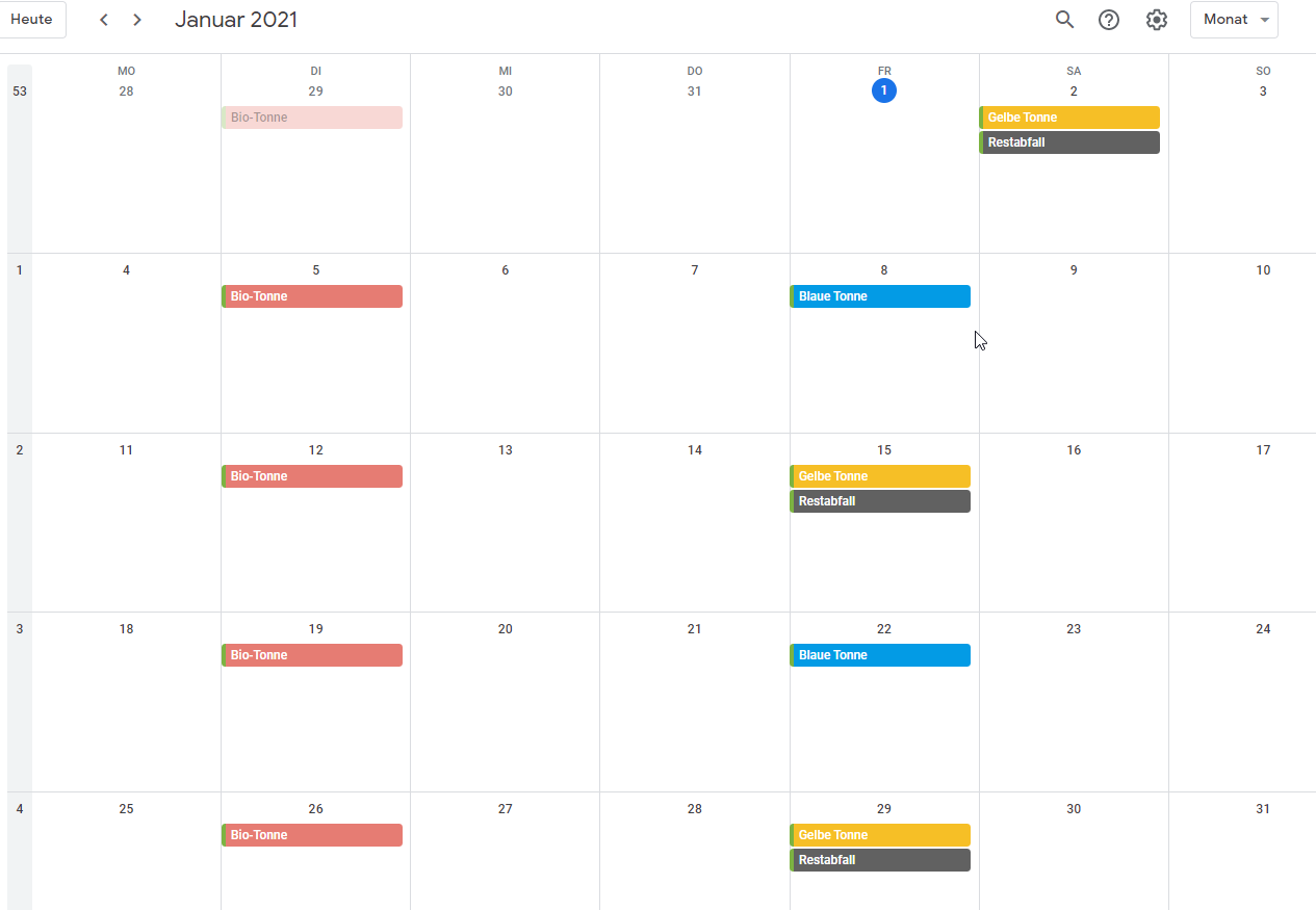

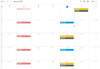

this i my google garbage calendar:
as you can see… today are no events. but somehow the TODAY items getting updated…
