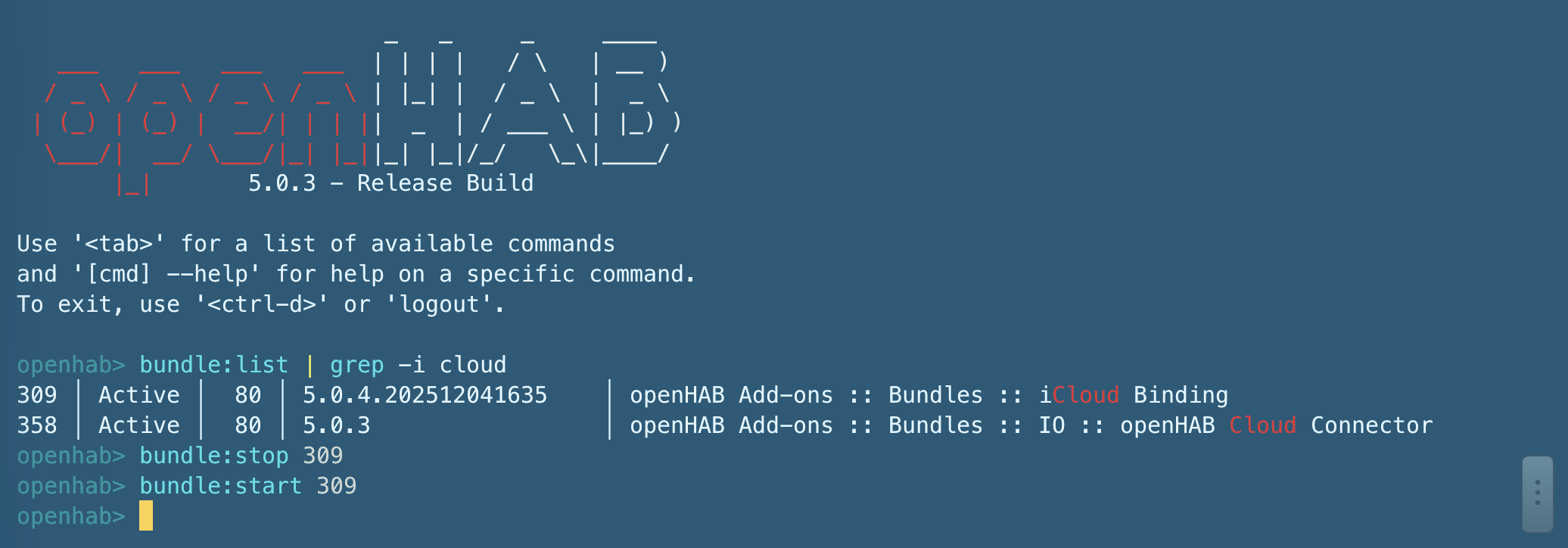

I‘ve installed it like this:
bundle:update 309 https://github.com/maihacke/openhab-addons/releases/download/17590-srp-5.0.x-beta-0/org.openhab.binding.icloud-5.0.4-SNAPSHOT.jar
If I would do this then it would stop the „openhab could“ not the iCloud, right?
I‘m not sure if this is intended
309 │ Active │  80 │ 5.0.4.202512041635    │ openHAB Add-ons :: Bundles :: iCloud Binding
358 │ Active │  80 │ 5.0.3                 │ openHAB Add-ons :: Bundles :: IO :: openHAB Cloud Connector
Sorry! I´ve not read the description and you used a different filter.
309 is correct and should work.
