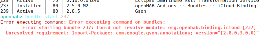

Hi, I follow all steps you mention and I have this problem. I get this message when I triy to start the icloud binding:
206 │ Active │ 80 │ 2.8.5 │ Gson
207 │ Installed │ 80 │ 2.5.0.M2 │ openHAB Add-ons :: Bundles :: iCloud Binding
openhab> bundle:start 207
Error executing command: Error executing command on bundles:
Error starting bundle 207: Could not resolve module: org.openhab.binding.icloud [207]
Unresolved requirement: Import-Package: com.google.gson.annotations; version=“[2.8.0,3.0.0)”
I need some help!

A few hours ago I had the same error as ramon2k10:
I assume that a restart of openhab2 fixed the problem:
