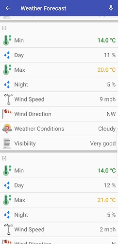

Above is a screenshot of my 3 day weather forecast. I’m trying to get the icon to reflect the state.
The state is derived from the uk metoffice xml and is mapped as a string item from a code to the string.
I have a transformation map that maps the state eg Cloudy to an icon myweather-cloudy
Cloudy=myweather-cloudy
sitemap example
Text=item........icon="myweather"
icons work for openweather which I use for current but nor forecast conditions.
Do I need use the original weather condition value (ie 0-19) or is there another reason this isnt working?

The bit of info you probably need is that dynamic icons are selected based on raw Item state, transformations are not taken into account.
That’s what I was wondering

So if myItem.state has string value of “19” I would expect it to use icon myweather-19.png and if not available to see myweather.png
