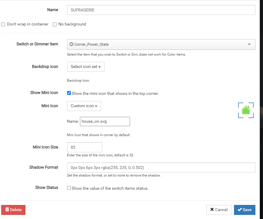

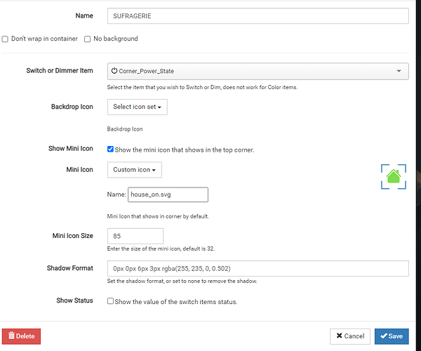

i have an widget that i use with custom icons in config.
I see one icon when is ON the button, but when is off is not showing.
What i did wrong?
icons are different one is with on and one with off..
Thank you for your time:)

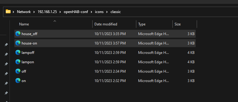

house-on.svg ( this works ) vs. house_off.svg ( this does not work ) thus it most probably has to be named house-off.svg ( dash instead of underscore ).
