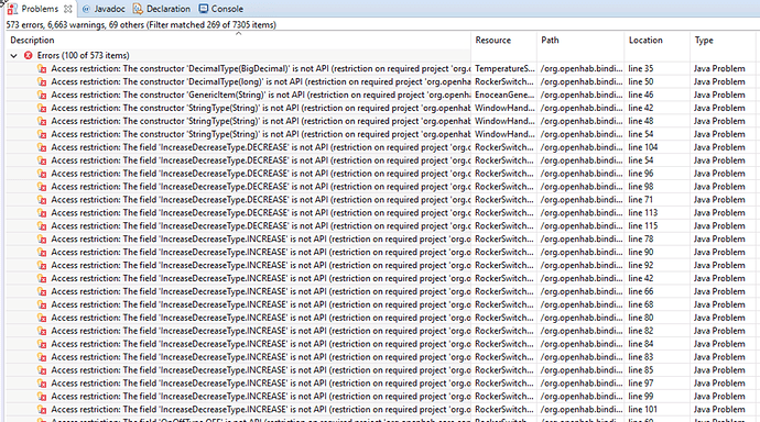

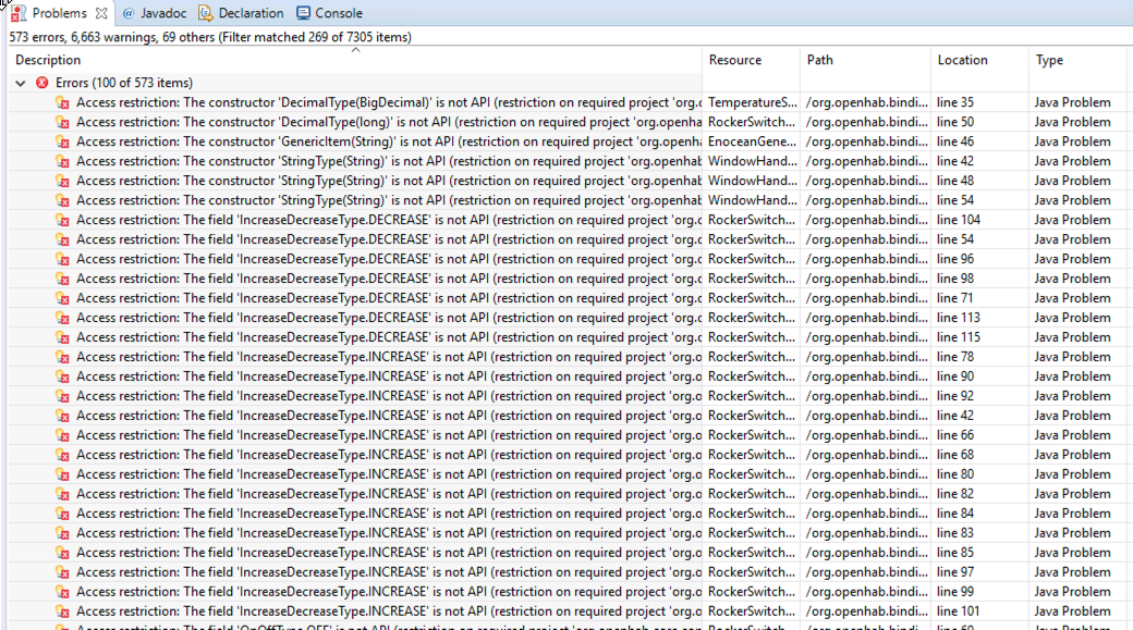

I had a similar issue with a new install, installed oxygen which seemed to help. However, with a new install i’m getting hundreds of errors (see below).
I’m completely new to this project and trying to make a new binding, so apologies if this is a stupid question. I’m new to java, eclipse and openhab :expressionless:
