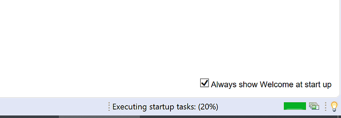

Going through it again. I suspect (one of) the problems was closing the ide to soon. I’ve gone through it again and now can see it’s trying to download everything.
Being on holiday with slow internet access, it might be a while :frowning:
So far, so good :slight_smile:

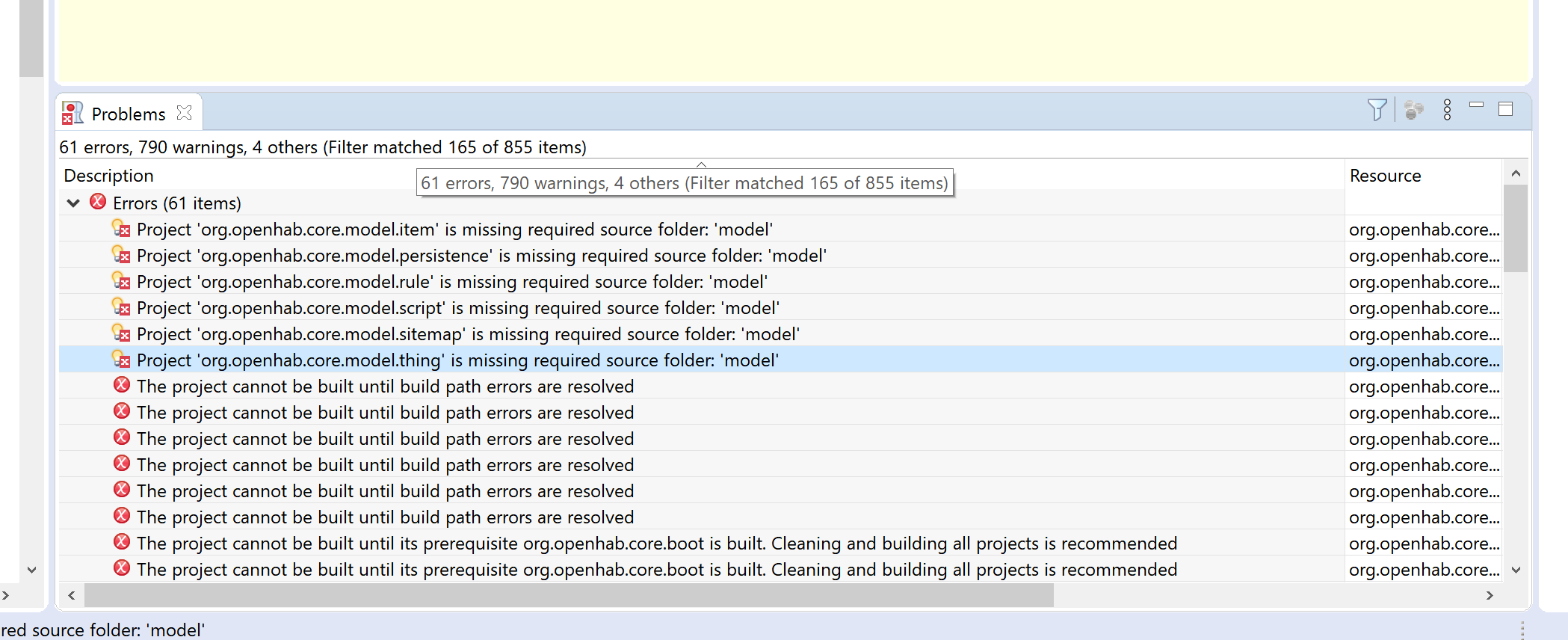

However, I get this in the IDE
I tried a clean and build and it remains as-is.

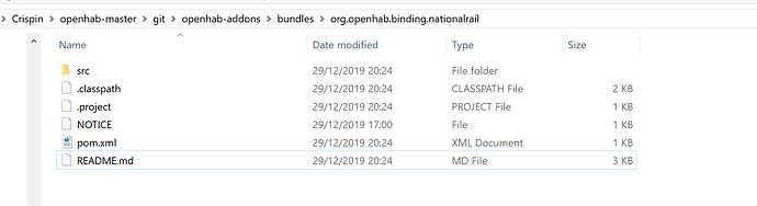

I created my own binding using the cmd file provided. That downloaded a shedload of stuff and finished with a success message.
I can now see the following

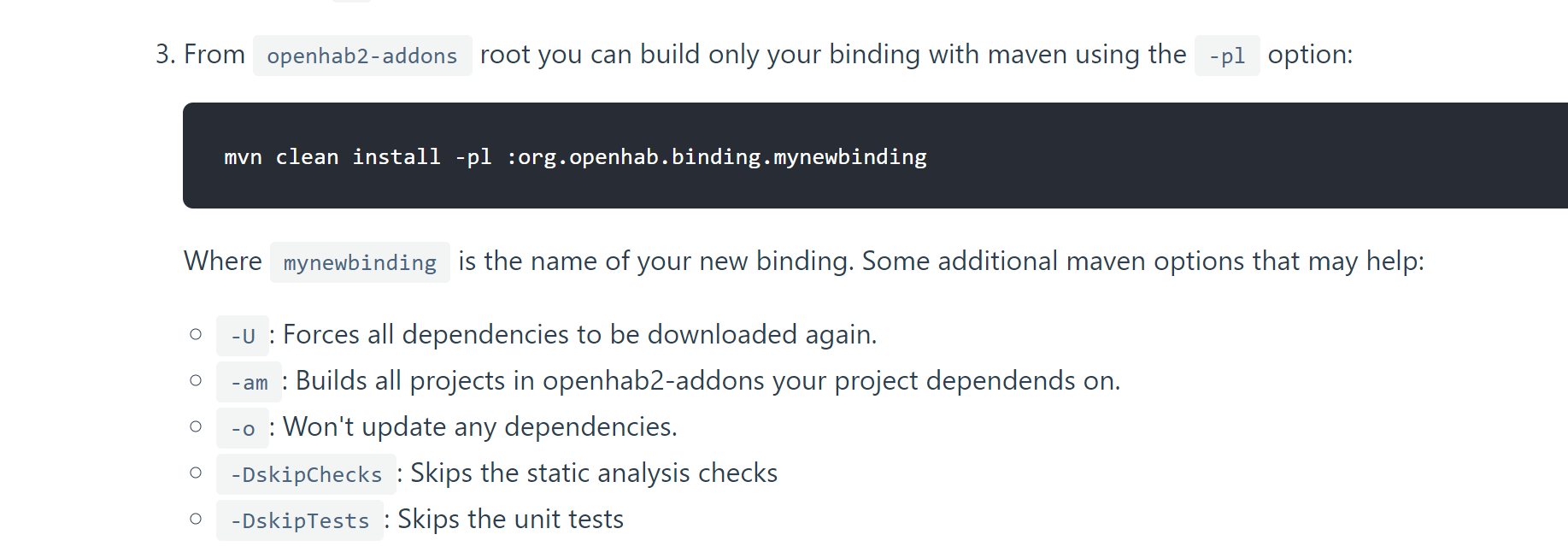

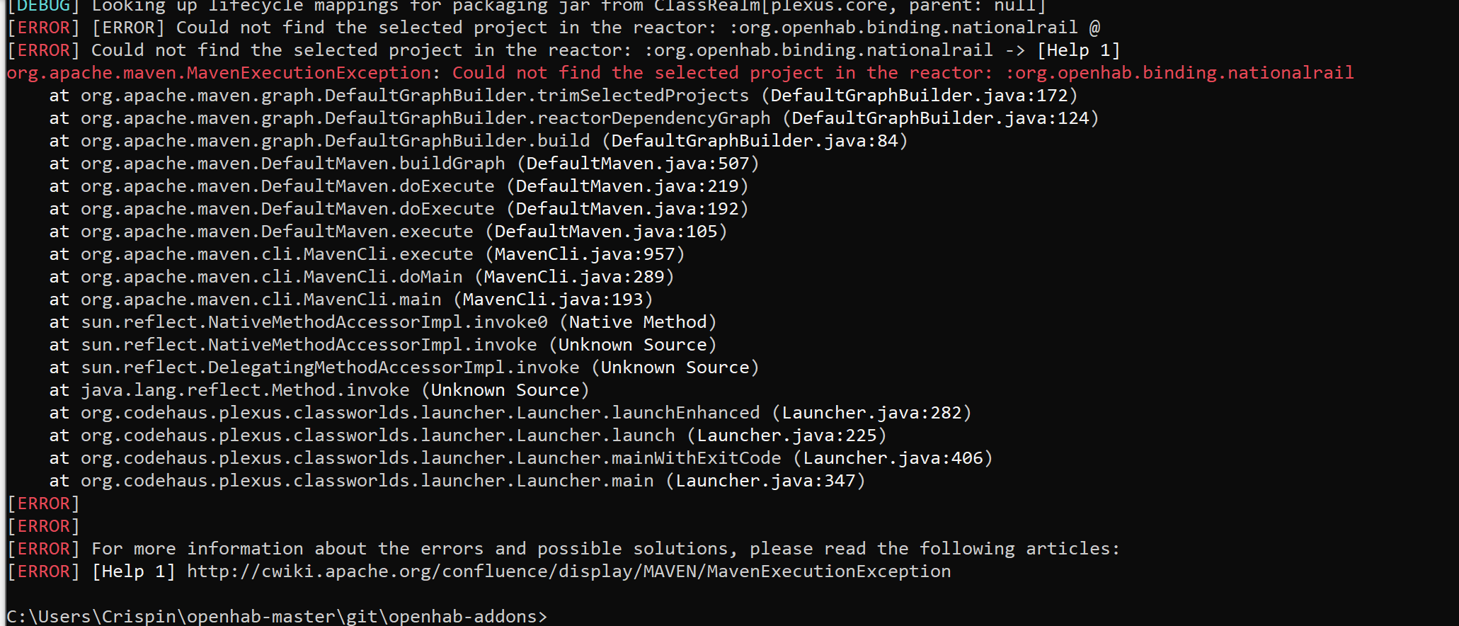

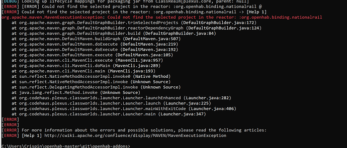

I now try the next step, mvn build, and get the following error
Related to the failed build above?
I’ve cleared everything down and tried again, making sure I (think I have) followed the documentaion
I still get this
Fresh out of ideas. The hint to read at the bottom of that message did not help me at all.
I don’t know maven, java or any of this so really learning as I go. Wish it were simpler :slight_smile:
Looks like your binding is missing in the bundle/pom.xml.
Did you create your binding with the skeleton script? And are you on Windows? Because that might explain why it’s missing.
Yes and yes.
Hi there,
@CDriver, same happened to me the 1st time I’ve created a binding with the skeleton script from a Windows 10 machine. Adding <module>org.openhab.binding.mybinding</module> to openhab-addons/bundles/pom.xml worked for me.

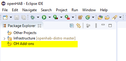

@hilbrand, I had to reinstall Eclipse IDE from scratch, followed again the updated doc and selected both projects - Development and Add-ons. Conversely from the 1st time now, after the build phase, I always end up with an empty OH Add-ons folder:
Any suggestion ?
Thanks :slight_smile:

Facing the same issue (on Windows 10). Different versions of Eclipse. Multiple retries with clearing .p2 and .m2 .
Did you find a solution for the empty OH Add-Ons folder?
@hilbrand Is there a solution?
Not sure if anyone is still struggling with this, but I discovered that the addons did download even though the folder was showing empty in Eclipse.
My solution was to Import the folder from my harddrive and it appears to be working (only limited testing carried out!!!)
