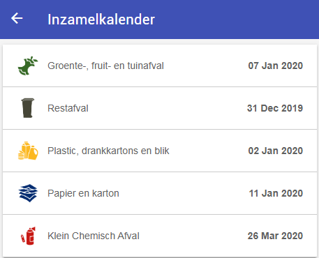

Some weeks ago a friend of mine came with the idea to “read” the local government office website and extract the dates on which the various types of garbage are collected. Great job by Corne! He made a script to do so and output the results to his domoticz system, which in turn would send telegram messages the night before to remind his family to set the correct type of trash outside. Very nice idea but done in java & domoticz. But all is working great (after some debugging).
So I took up the challenge and re-wrote the thing in Python + Openhab-Python interface. The end-result is shown below. An overview of all garbage collecting moments, daily updated and a telegram message the evening before and early in the morning.
Result
How does it work?
Basically crontab on my PI runs a python script named “afval.py” once a day (afval = trash in Dutch). The script is attached below. It basically gets the webpage of the city hall, uses PyQuery to understand the page and then finds the correct data. Then do some processing as the year is not included in the data. Then the script connects to my openhab and sets the items shown in the figure above.
