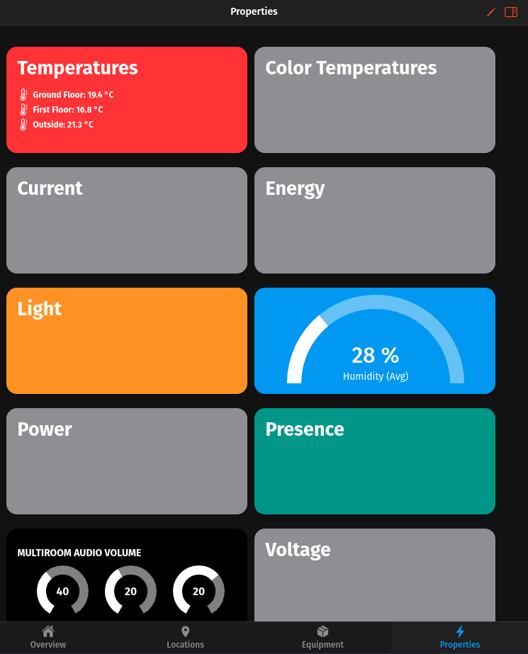

Also if you wondered why these cards outside Locations were so big, it’s because they were always meant to display more than a title and background. But generating stuff automatically like for locations was too difficult and never done.
You can add whatever you want yourself though:
      Humidity:
        - component: oh-property-card
          config: {}
            header:
              - component: oh-gauge
                  borderBgColor: rgba(255,255,255,0.4)
                  borderColor: white
                  borderWidth: 20
                  item: ZW074Sensor_Humidity
                  labelText: Humidity (Avg)
                  labelTextColor: white
                  style:
                    margin-left: 30px
                  type: semicircle
                  value: 60
                  valueTextColor: white
      SoundVolume:
            backgroundColor: black
            header:
              - component: f7-link
                  style:
                    color: white
                    font-size: 14px
                    text-transform: uppercase
                  text: Multiroom Audio Volume
              - component: f7-block
                  style:
                    color: white
                    display: flex
                    flex-direction: row
                    justify-content: space-around
                    width: 320px
                  title: Multiroom Audio Volume
                  default:
                    - component: oh-knob
                        class:
                          - card-prevent-open
                        item: MusicCast_Salon_Volume
                        max: 110
                        primaryColor: white
                        secondaryColor: gray
                        textColor: white
                        class:
                          - card-prevent-open
                        item: MusicCast_Chambre_Volume
                        max: 50
                        primaryColor: white
                        textColor: white
                        class:
                          - card-prevent-open
                        item: MusicCast_Bureau_Volume
                        max: 30
                        primaryColor: white
                        textColor: white
      Temperature:
          config: {}
            glance:
              - component: oh-link
                  color: white
                  iconColor: white
                  iconF7: thermometer
                  style:
                    font-size: 12px
                    margin-top: 8px
                  text: "='Ground Floor: ' + items.GroundFloor_Temperature.state"
                  color: white
                  iconColor: white
                  iconF7: thermometer
                  style:
                    font-size: 12px
                    margin-top: 3px
                  text: "='First Floor: ' + items.FirstFloor_Temperature.state"
                  color: white
                  iconColor: white
                  iconF7: thermometer
                  style:
                    fontSize: 12px
                    margin-top: 3px
                  text: "='Outside: ' + items.Outside_Temperature.state"
Use the glance slot to add stuff below the title or the header slot to redesign the entire card.

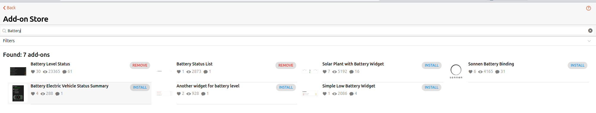

I would like to see the personal widgets sorted when adding to a page.
Currently it is not sorted and sometimes it is hard to find the widget that is wanted to be added.
Maybe add a filter to find the widget easier?
Search works even for marketplace widgets.
Never mind. You are not talking about installing widgets. Indeed, if you have more than just a few there that list is pretty hard to use. Search, sort, and stuff like that would be nice. I’d like to see that look the same as the Item selection dialog really.
