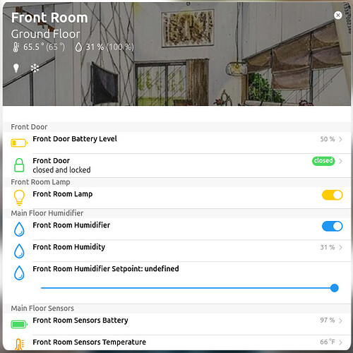

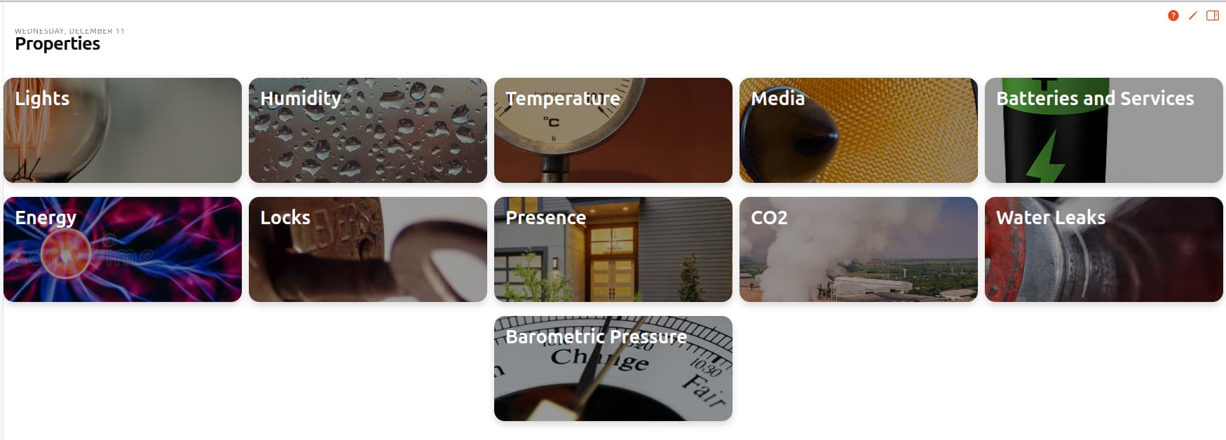

The Overview page inclues three tabs: Locations, Equipment, and Properties. These are three different views of your semantic model.
On each of these tabs the main widget are List Item Cards. On the locations page the the card inclues badges so you can tell at a glance stuff like number of lights on, open doors, temp, humidity, etc.
Clicking on any individual card brings that card up where you get an ordered list of widgets showing and allowing you to control all the Points in that card. What Points are shown depends on that Point’s position in the semantic model. The widget that is shown by default for the Item is chosen based on the type and semantic model tag (e.g. a Number with the Setpoint tag will be rendered with a slider widget) and other info that’s part of the Item (e.g. State Description). The icon comes from the Category of the Item.
Clicking on the > for those widgets that have it (e.g. sensors) brings up an interaactive chart of that Item. On the Properties tab there is an “Analyze All” button which will show a chart of all the Items in that card.
All this comes for free. No configuration required beyond creating your Items and building the semantic model.
However, if the wrong widget is selected as the default, then you get into the place where you need to start customizing stuff. Here you need to add a “Default list item widget” to the Item that’s wrong. You can select from among the list of your custom widgets or you can configure a widget right there.
If the order isn’t what you want you have options to control that too. And you have some customization options for the cards (e.g. I have some custom background images on my cards.

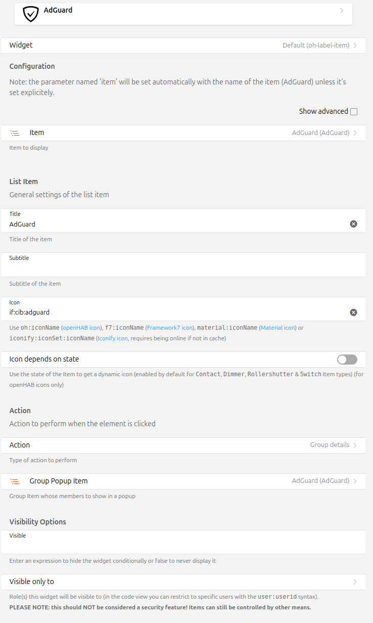

Note, if you use a custom widget, you can then edit that widget under Developer Tools → Widgets and those edits will apply everywhere it’s used in a “custom X widget” Item metadata.
Anyway, yes, it does add finished widgets based on the properties of the Item.

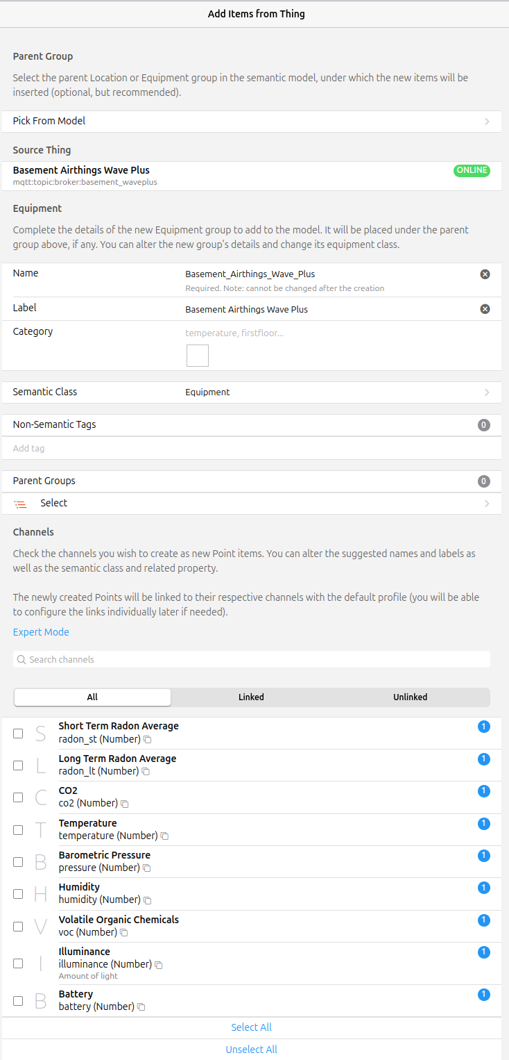

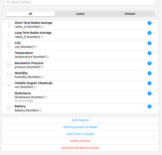

It’s not a wizard but this is exactly what you get when:
  • From the Thing’s Channels page clicking on “Add equipment to model” or “Add points to model”
Which brings up:
You can select the Location, create the Equipment Item (if you choose “Add points to model” you don’t get the option to create the Equipment and instead can choose it) and then you can select which Channels you want to include in the Equipment. Once selected you get a pre-filled out form with most of the properties of an Item that you can override as needed.
When you hit save new Items will be created for each Channel you selected already situated in the semantic model.
As discussed above, you already get a UI for the newly created Items since they are semantically tagged and this UI is the default dashboard.
