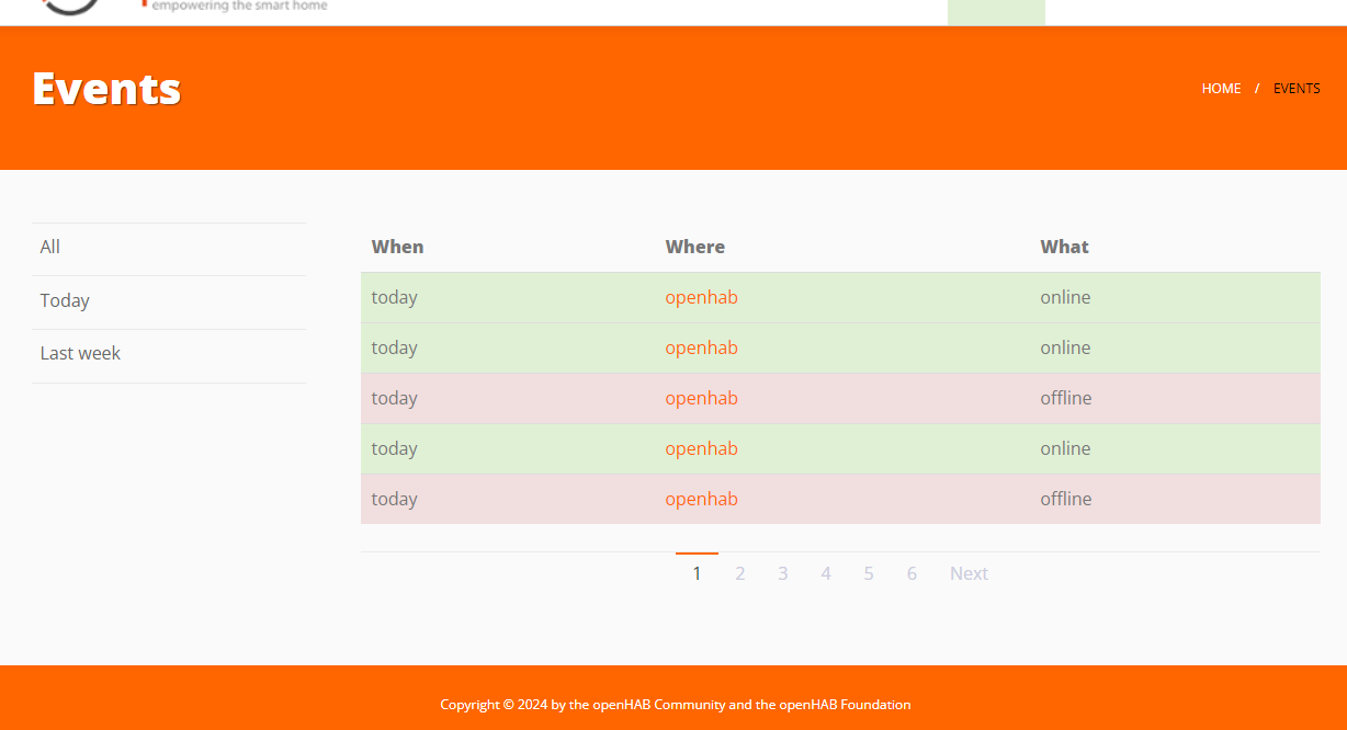

Cloud Connector could can now report when OH local system disconnect?
accordingly with OH 4.2 improvement Annouchment I want to ask you if now is possible to push a message notification From OH Cloud to my phone If Events in OH Cloud see that OHLocal service goes from Online to Offline ???
Will be a great feature in my opinion.
Thank for clarifications
