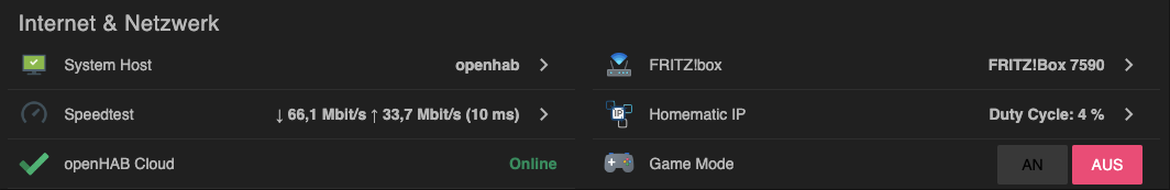

When the connnection test starts, the string will be updated to Testing. We’ll then send a command through myopenHAB to change the string to Online. If the command succeeds, it’s not necessary to restart the cloud connector.
If you want, you can add this item to a page or sitemap as an indicator of the cloud status.

I use this Item in my UI. Works fine for now and looks good :wink:
