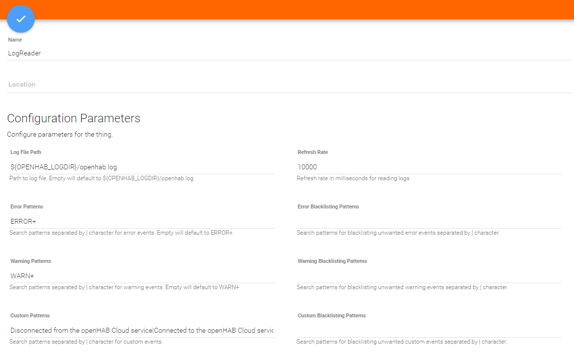

So first of all I created a logreader thing:
And as Custom Patterns I used this string (please note the pipe-sign between the 2 strings):
Disconnected from the openHAB Cloud service|Connected to the openHAB Cloud service
I also increased the Refresh Rate from 1000 to 10000 milliseconds as this should be enough and events less than 10 seconds shouldn’t create panic.
