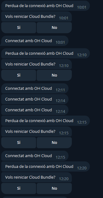

There is some bug on Opencloud Connector from last OH version (3.4.1), because is all day reporting Disconnections / Connections to the cloud on Log, and sometimes it really doesn’t reflect the connection status really.
Yesterday, a little example, all day was doing this:
Today seems to be more stable at now.
Ruben
