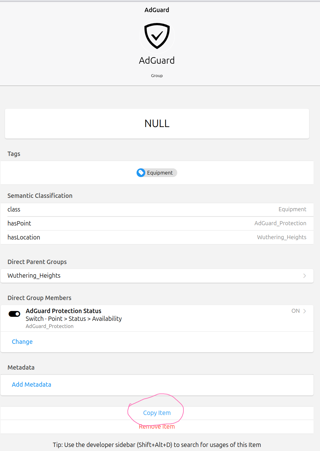

Right now there is no duplicate option. Even not considering “quick edit” options, the fact that we could duplicate one item would already be amazing.
Awesome. Good to know! :slight_smile:
There is a similar option for Things. Though until relatively recently there was a bug when duplicating Things related to the Channel UIDs. I think that fix was backported to 4.3 but I’m not certain.
Indeed there is. Since I’m still in 3.4 I didn’t know that. Anyway, still my suggestion applies to Items. I will definitely have to consider upgrading to 4.x I’m just kind of scared on the amount of time that will take me! :smiley:
By most accounts the upgrade between OH 3 and OH 4 was the easiest upgrade process yet. With the development of the upgradeTool, if you are using managed rules many/most of the breaking changes get fixed for you as part of the upgrade. Compared to previous major versions, the number of user facing breaking changes was way lower as well. Many were able to upgrade without changing a thing.
It is possible to create duplicates of both Items and Things.
@rlkoshak posted a screenshot from the Items menu, so what is wrong with that ?
Man this has been a though day! :smiley:
Since I’ve read Rich saying:
I immediately assumed (without properly looking into the image) that only existed for Things.
