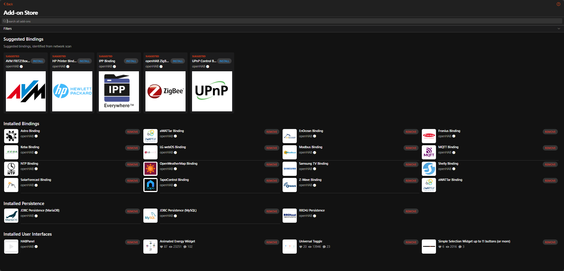

Installing JS is not possible as it is not advertised in the “AddOn Store”, in fact, nothing is advertised there anymore, all I can do is uninstall the addons I have installed so far.

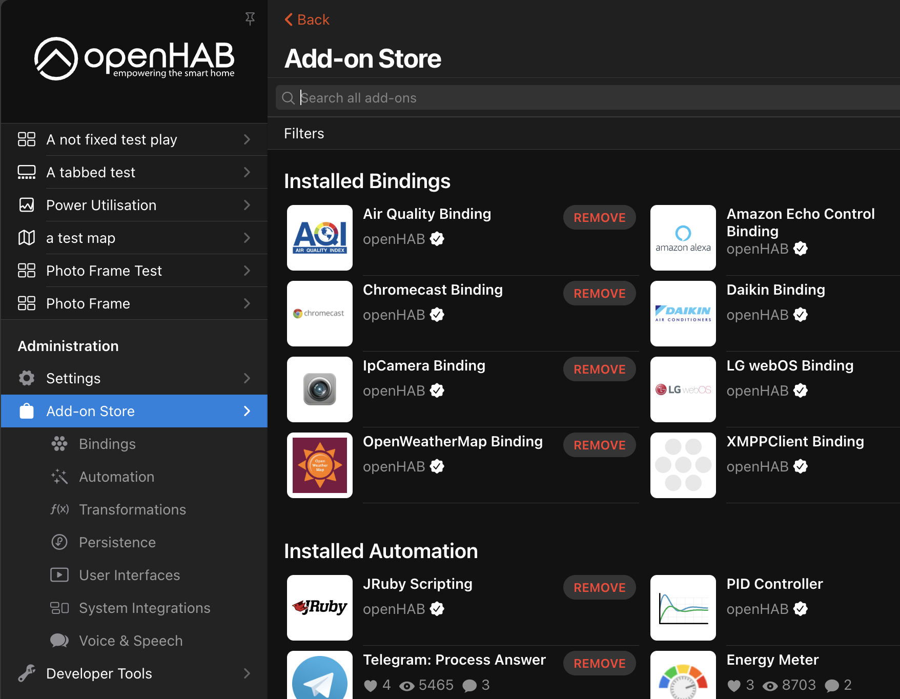

I redesigned this page some time back. I hadn’t considered this particular scenario with the sidebar not visible.
You’d need to pin the sidebar/menu so you can see the submenus, where you can see “Automation” to install JSScripting.
Alternatively you can type “jsscripting” in the search bar.
I’ll make some changes to accommodate this screen when the sidebar menu is not visible.

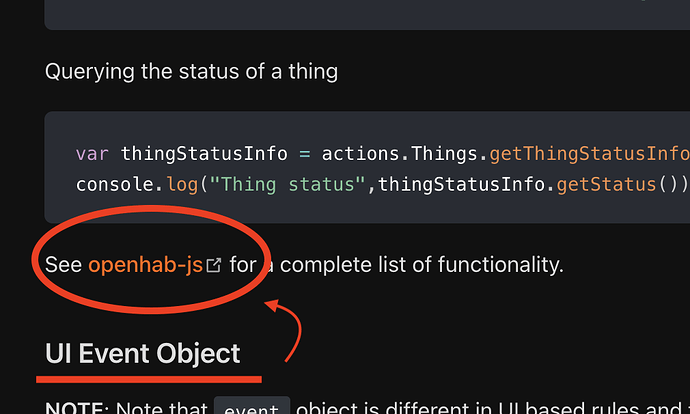

Can you please direct me to the “docs” for JS?
(Beside this JavaScript Scripting - Automation | openHAB
as it is useless, there is no entry point.
It tells me to store the “rules” in “openHAB-conf\automation\js”, but not with what ending.

https://openhab.github.io/openhab-js/
The link is located here:
