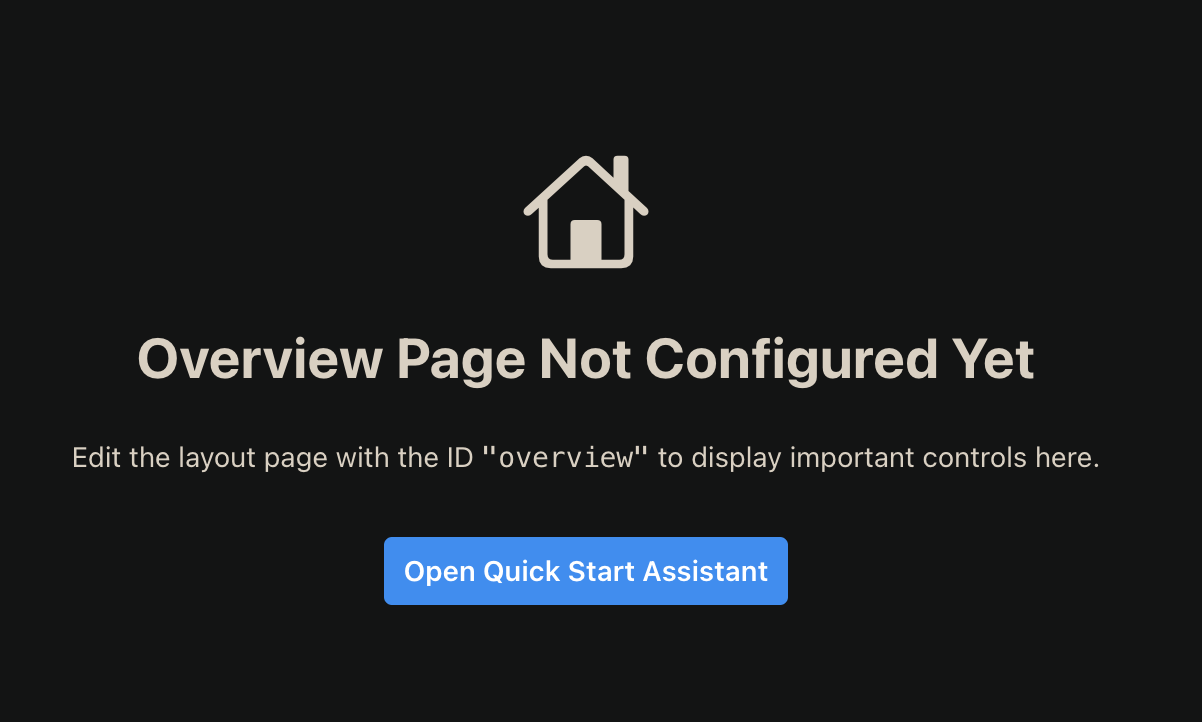

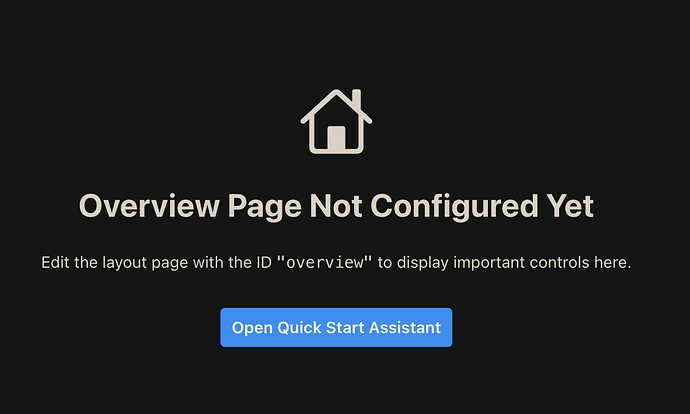

Then I was brought to the overview screen
When I clicked the button, the quickstart sidebar appears, but step1 suggests me to install a binding. Haven’t I just done that in the initial step?

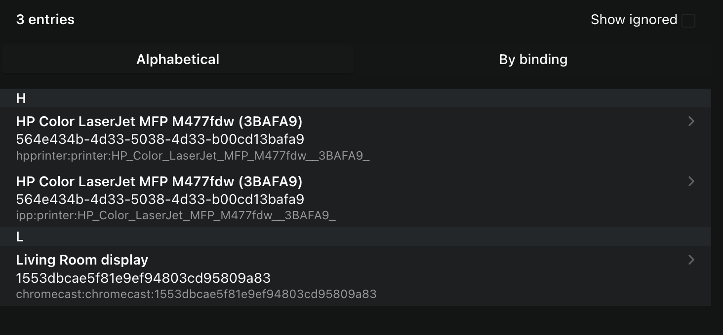

As a result of having both HP Printer and IPP binding, I ended up with two entries in the inbox, related to my printer.
  • We should perhaps have some sort of mechanism for binding priority, e.g. if HP and IPP are both detected, give priority to HP and do not suggest IPP binding. @AndrewFG (from memory the addon suggestion was your baby, so you would know more about this)

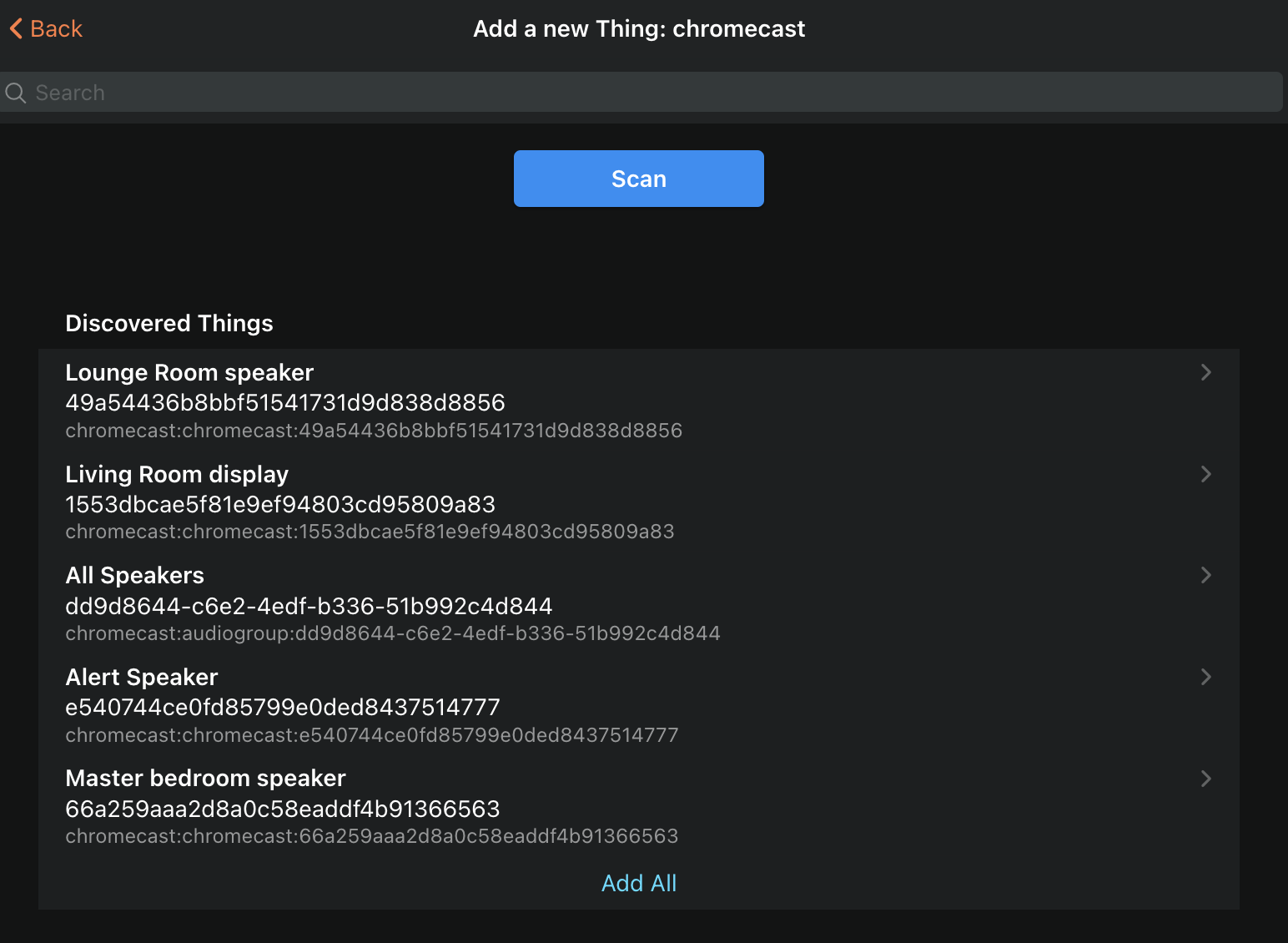

It also detected one chromecast device. I have 4 in total. I wonder why the other 3 weren’t found automatically at this point
Then I clicked + and selected Chromecast Binding and clicked Scan.
Now it finds all my chromecast devices. This should’ve been found from the beginning.
Then the Add All link / button is not clickable. This is a bug?

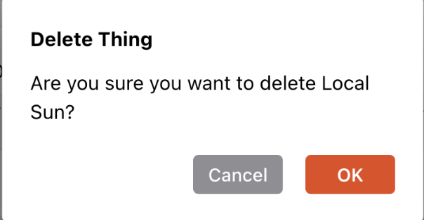

I have no idea whether this is the case right now but I guess deleting a thing should also give you the option to delete all the channels + linked items.

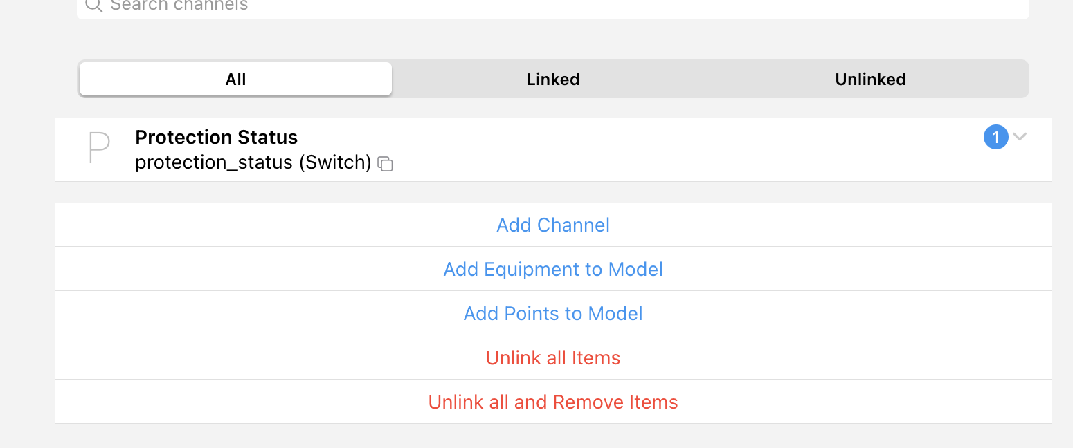

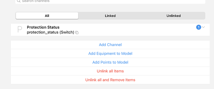

You have the option but it’s a two step process. First you have to delete the Links (and optionally the Items) and then you can delete the Thing.
The problem is you may not want to delete the Links and Items (e.g. upgrading or rediscovering a Thing to fix some problem) so it needs to be an option, not automatic.
Currently (4.1.1) doesn’t ask when you delete the Thing if you want to also delete the Links and Items too all in one go. But that surely could be added to the confirmation dialog.
