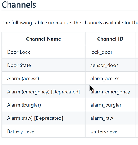

What do you mean by that the alarm_raw channel is deprecated? I havent updated my setup in some time so I’ve lost track. Is there something else replacing it? It’s still working in my setup.
The deprecated statement can be found in the documentation for the binding towards the lock when firmware version > 1.5
I created some rules based on the alarm_raw and it is working nice for me too, so guess it will not be removed in a while
I checked Id locks home page and they’ve released a new firmware of the module (1.6) where it seems like they’ve extended the functionality of the access control channel to cover what the alarm raw did. However, I don’t know how this will work in practice in OH2.
