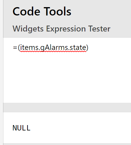

Item state is NULL

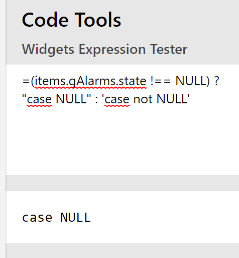

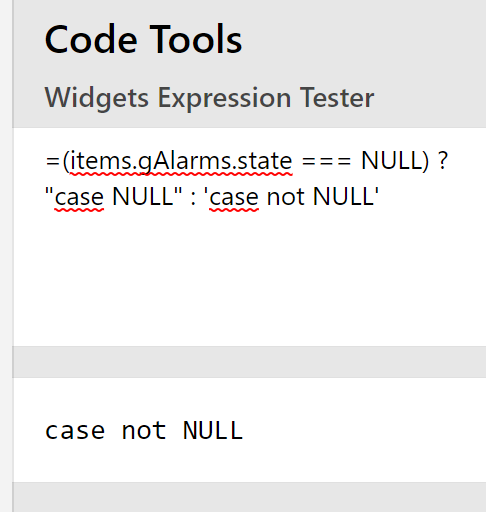

when building an expression with “IF” I get the wrong result:
double check: replacing === by !==:
