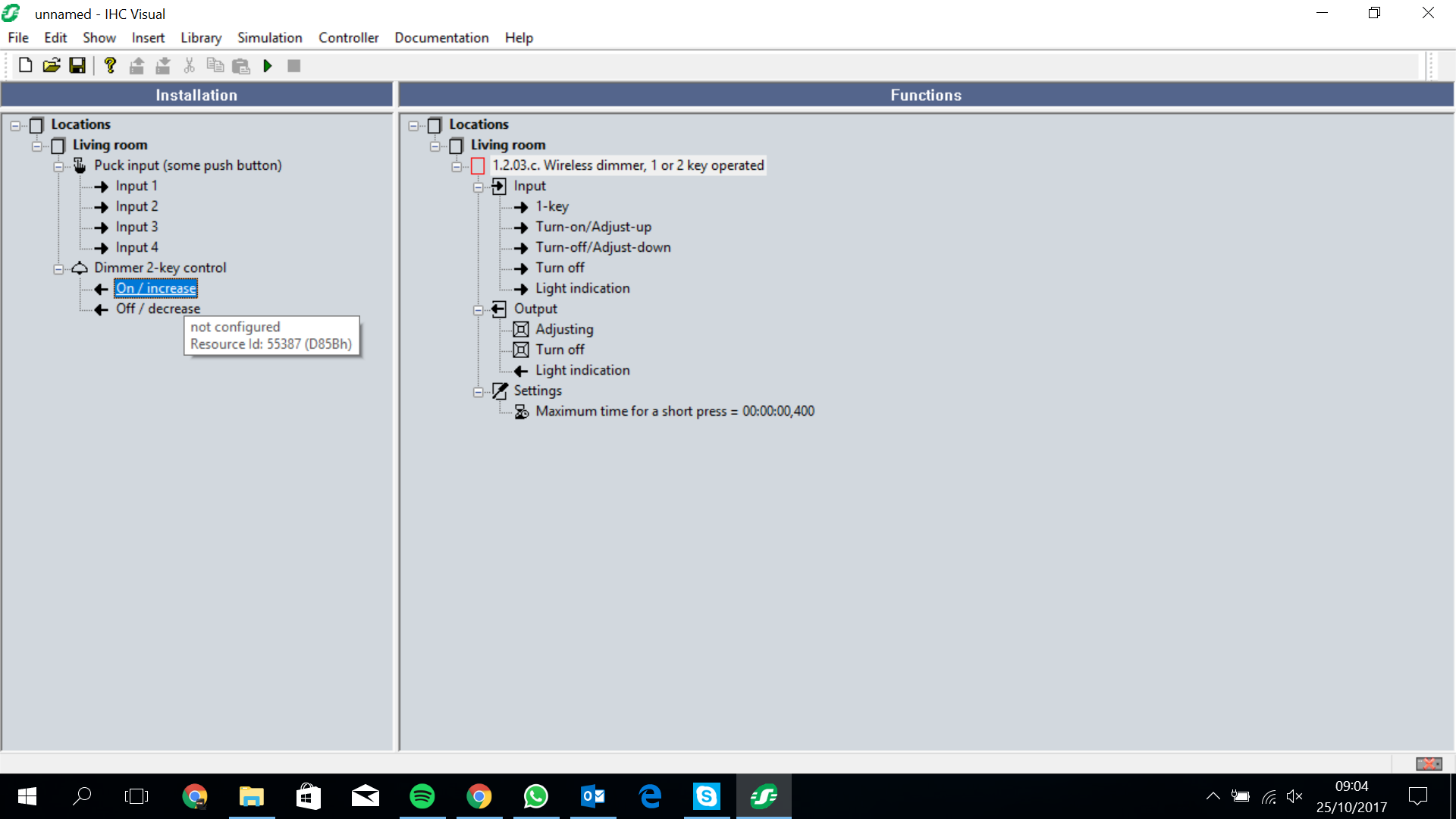

You can find the Hexadecimal value on the IHC Visual:
Hold the ctrl button on the keyboard, when you make the mouse over. ![]()
