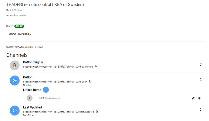

I tried the remote control which is linked to the lights with normale commands ON/OFF (switch) and as Setpoint which also doesn’t work for the remote control (but works when I directly communicate to the second device) the same effect…
  1. the item (button event) are also receiving the commands ON-OFF and 0, 1, 2, 3… but nothing happen
    I think that’s because the button event can only trigger in a rule → Button Event on Tradfri remote not working with new deconz binding - #2 by cweitkamp
    in this topic, the on-off seems to work and can be triggered with the trigger channel
  2. the “button” can’t handle a switch, any ideas on how to use it?

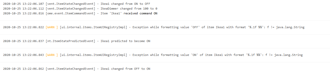

2020-10-25 01:12:44.314 [WARN ] [rest.core.internal.item.ItemResource] - Received HTTP POST request at ‘items/Fernbedienung’ with an invalid status value ‘OFF’.
2020-10-25 01:12:46.235 [WARN ] [rest.core.internal.item.ItemResource] - Received HTTP POST request at ‘items/Fernbedienung’ with an invalid status value ‘ON’.

but for what is the channel “button”…
I hope someone can explain :slight_smile:
well I can see, that my item which is linked to the “Button” receiving some numbers
ON / OFF via remote → triggers 1002
Dim to 1 via remote → triggers 3001
Dim to 62 via remote → triggers 3003
i tried to trigger it with Setpoint and the Values but nothing happend.

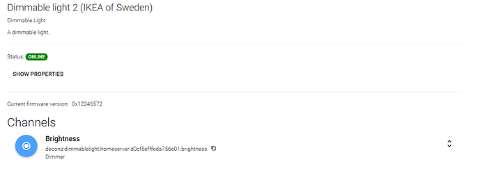

the thing shows up as a dimmer and :brightness
well… i tried something like this
Switch Ikea “Helligkeit Küchenbeleuchtung” {channel=“deconz:dimmablelight:homeserver:d0cf5efffeda756e01:switch”}
and i dont know why, the lamps are reaction on this switch and openhab is receiving the state ON and OFF
I am not sure if this is a great solution… it seems like try and error and lucky that it workes why it should not work… am i right ?

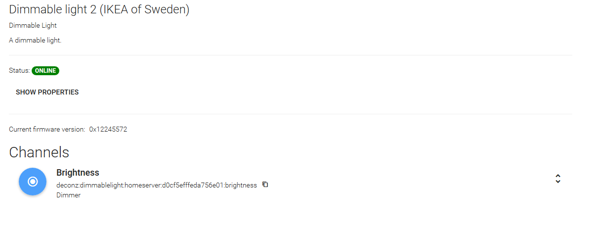

You shouldn’t be fiddling with a dimmer to try and make it match a remote control. Let’s set the dimmer up properly.
The deconz binding offers you a Dimmer type channel.
Link that to a Dimmer type Item only.
Perhaps you have not realized that Dimmer types in openHAB support ON/OFF commands as well as 75% etc.
Put that Item on your UI with a slider, and also separately put it on your UI with a switch. Demonstrate to yourself that you can do on/off and dimming controls.

The switch item expects ON/OFF the sitemap will display ERROR.. i think its because he expect percentage
Is there a workaround ?

Nope. I meant to create one Item of Dimmer type and link it to your dimmer channel.
You may show the same Item on a sitemap in a number of different ways at the same time, including showing a Dimmer type Item as a Switch widget.
As I said, lets get the dimmer right before messing with remote.
Okay lets do it :slight_smile:
yep, I deleted all and created just one Item for the dimmer.
I displayed it as a switch and as a setpoint on my sitemap.
.item
Dimmer IkeaKuechenbeleuchtung “Küchenbeleuchtung” (IKEA) [“Lighting”] {channel=“deconz:dimmablelight:homeserver:d0cf5efffeda756e01:brightness”}
sitemap
Switch icon=light item=IkeaKuechenbeleuchtung
Setpoint icon=light item=IkeaKuechenbeleuchtung minValue=0 maxValue=100 step=25
It’s doing well, I can dim and turn it on and off
only the switch slider is not doing very well, he’s randomly switching to on and off … sometimes at 50% at 100% to ON
Greetings
I don’t know what that means really.
The switch widget should really show ON for any value 1-100, and OFF for 0.
Maybe your UI does not update very well.
yep its cause the ui doesnt update well.
But it works fine
If you look in your openhab.log at the time your sitemap file loads, there may be a clue as to a reason for that.

There is an event (trigger) channel. You can’t link that to an Item directly, as it a passing event in an instant, not a static state. But you can use it to trigger rules.
// a skeleton rule to examine behaviour
rule “IKEA events”
       Channel "deconz:switch:homeserver:14b457fffe77df1e011000:buttonevent" triggered
      // receievedEvent is an implicit variable with the code in
   logInfo(“ikea test”, “IKEA button event” + receivedEvent.getEvent())
You’d be expecting your codes like 1002 etc, and you can work out what poking makes what code, so later on you can choose what you’d like to happen.
There is also a regular Number channel, which you can (and have) linked to an Item. I don’t know how that works - does it post a code for last button pressed? Does it change when the button is un-pressed? What happens if you press the same button twice? You can work that out from your events.logs. It might be less useful than the event/trigger channel.
