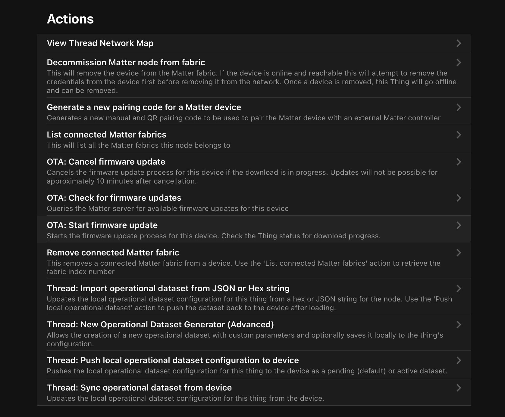

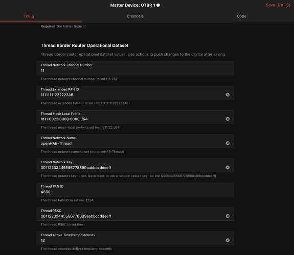

So we have support for these in our binding today, and at the time i added this, we were the only vendor yet to support it, but thats changing soon, at CES there were a number of products announced with TBR matter clusters in them, so they are coming.
There is still work todo here i"m sure (i need more time to play with this stuff), but the foundation is there and i’m using it today to manage my 2 TBRs. The real value, at least to me, is being able to manage multiple TBRs with the same config (operational data set) from one place. This allows multiple TBRs to participate in one logical network which is awesome.
Configuring TBR parameters in openHAB (esp32 TBR running the official matter chip build)
TBR actions

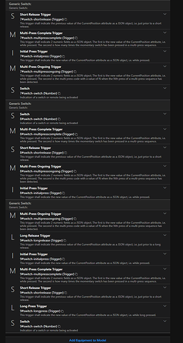

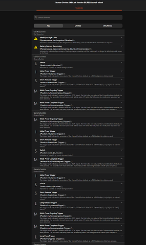

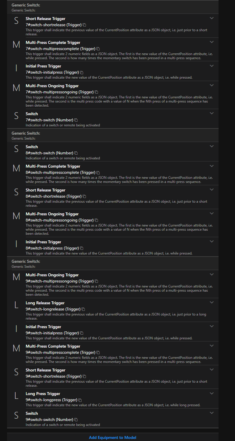

Matter Device: IKEA of Sweden BILRESA scroll wheel
FYI, 3 sets of 5+5+7 channels:
Question: DSL is still my preferred rule language, but I believe it is not possible to get hold of all the multiple entry payload from these Trigger channels?
Payload is in variable receivedEvent.
You need to install JSONPATH transformation and then you can retrieve the different information from the payload like that:
