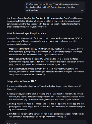

Is this the correct way to go, or will the OH Matter binding (or other) be able to talk to the conbee Radio Co-Processor (RCP) directly offering the same service as the OBTR Daemon?
I don’t think the OH Matter binding has support for using a thread radio directly (like the z-wave and ZigBee bindings), and not sure if there’s any plan to add that either.
Z-wave/ZigBee is simpler in this regard, since all the communication layers are handled by the same stack. Matter has support for several different protocols at the physical and data-link layers (thread/WiFi) that may require different hardware. But it has a common protocol for the network layer (IPv6), which is handled by the OS. Then there is the matter-js component that the binding uses, that manages device pairings etc. On top of that are the matter clusters (application layer) that is handled by the binding. (Correct me if I’m wrong here @digitaldan but this is how I have understood things)
So there’s a lot of moving pieces here, and while not impossible, having the binding handle two separate things in different network layers, with other components responsible for things between those, would likely be more confusing for users.
I was a user of conbee II. Since I did not use it anymore, I decided to flash it with the thread RCP firmware (thanks by the way to have pointed out this possibility!). Unfortunately, I was not able to configure OpenThread correctly to make it a functional thread border router.

Did you flash your conbee III USB stick with the thread firmware ? The error means that the USB stick does not respond correctly. Did you check that the /dev/ttyUSB3 is really associated with the conbee III ?

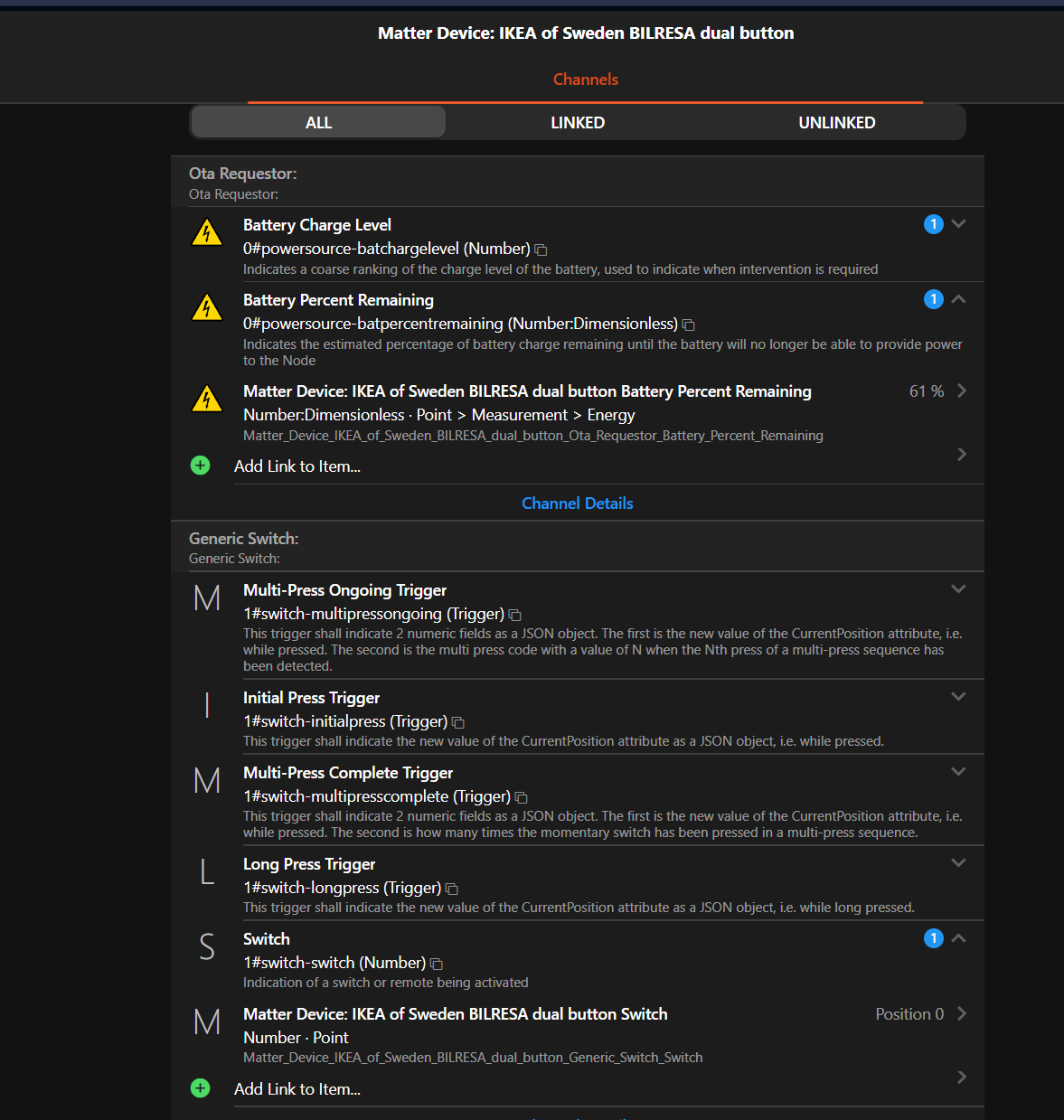

With the great help from @gd35 and AI I finally succeeded in pairing an Ikea Bilresa Dual Switch on the OTBR and also pair it to the Matter Binding in OH:
Only HW needed was a re-flashed Conbee II/III USB Dongle …
Only SW used was OTBR CLI tools + OH. No phone App.
