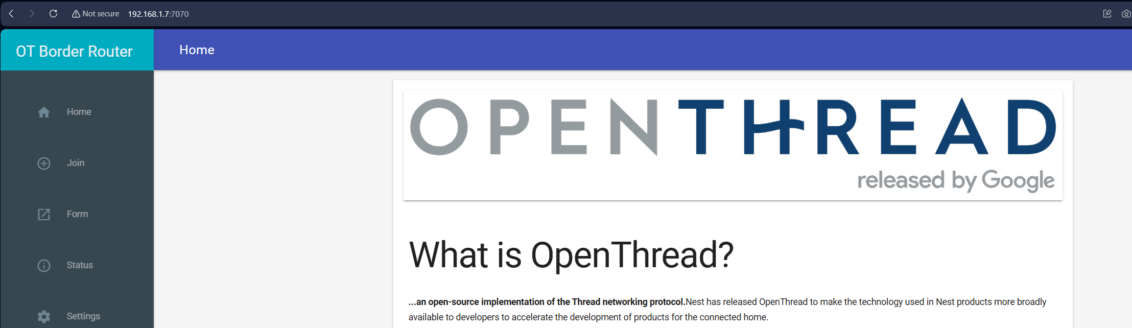

Now, if you can open the WEB GUI, all is well:
If not, check the logs for any complaints:
sudo snap logs -n 100 -f openthread-border-router

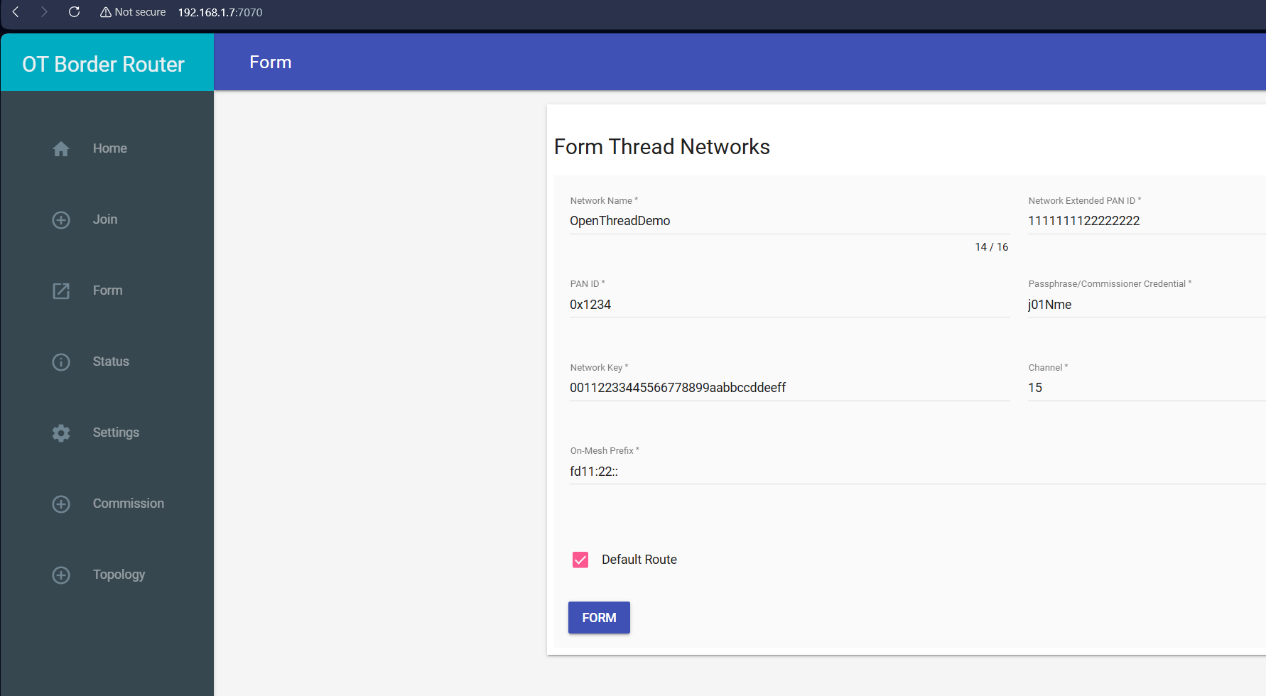

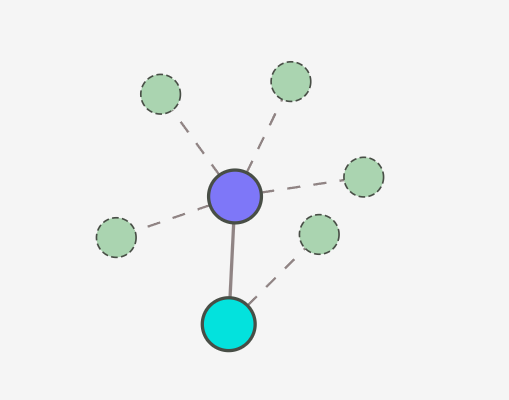

When radio is found and ip6 is OK on the wan interface the otbr should start.

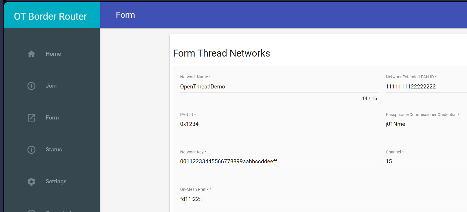

Using the WEB, Form a Network:
Edit fields to your liking, and write them down or take a snippet and save it.

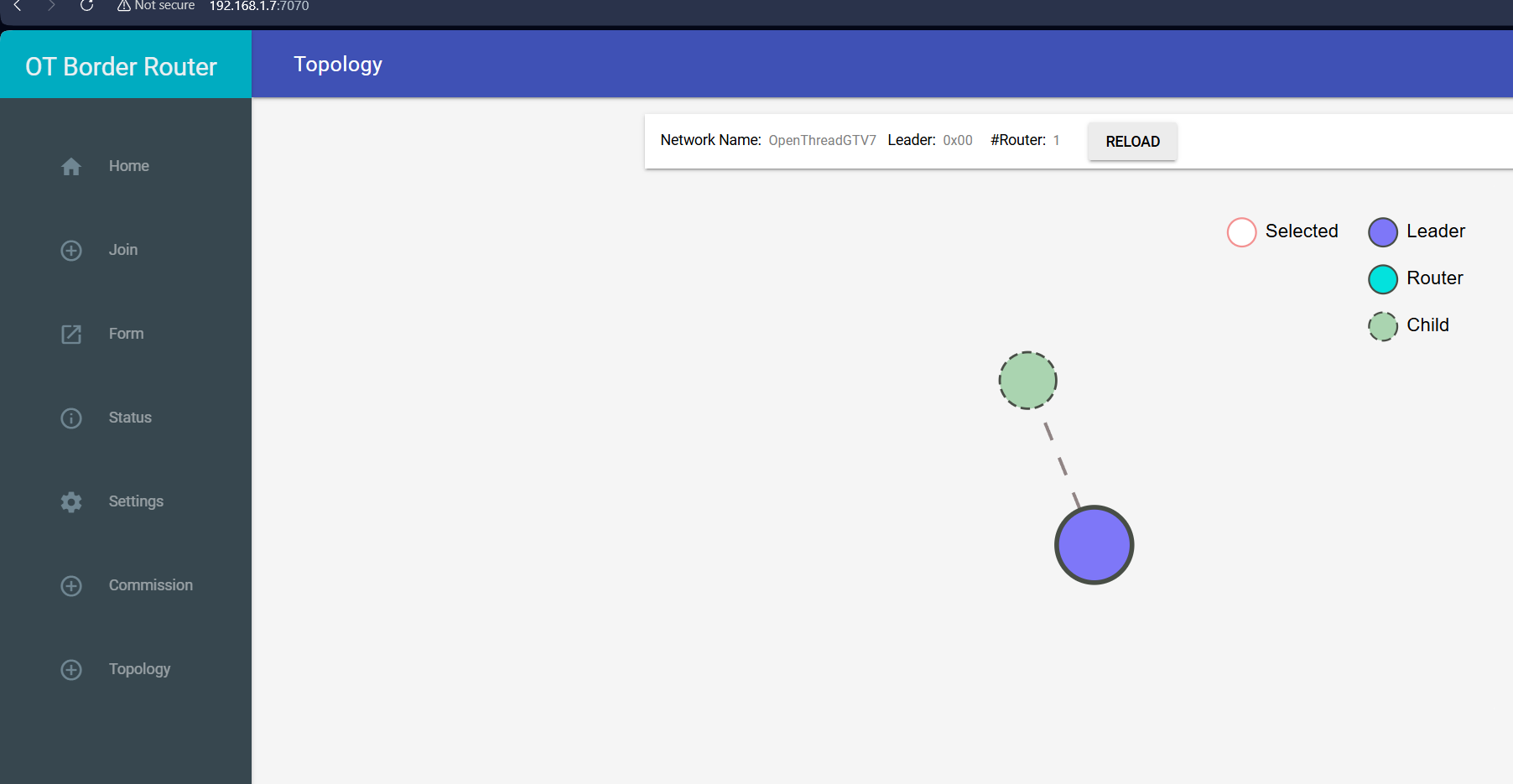

Now you should have a Topology, but without any children:
Now we are read to pair a device so it will look as above.

Your topology should now look as above.

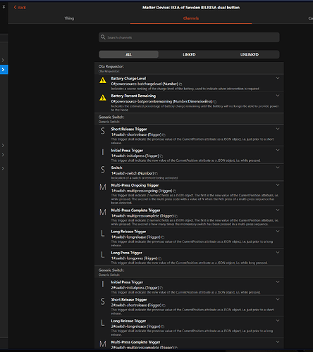

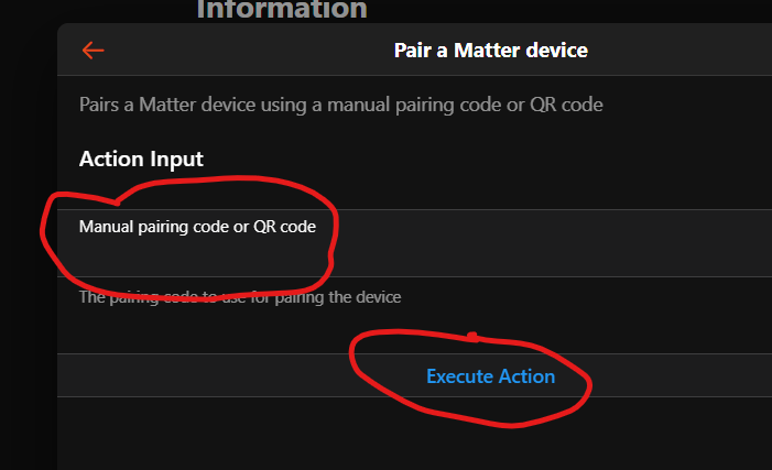

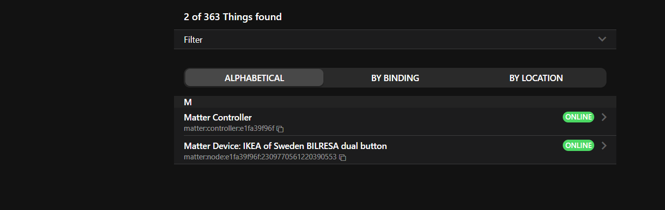

Now, head over to OH:
Create a Matter Controller and use the pairing code from the grep above:
Note that the Commissioning window closes after a while. Not sure when but you should have several minutes. I also had to try more than one time, but never more than 2.
Good idea to check you Inbox count to see if it gets incremented. Can take a while before it appears and also before the red Comm. Error and the Yellow Awaiting data terminates in a glorious green Online :slight_smile:

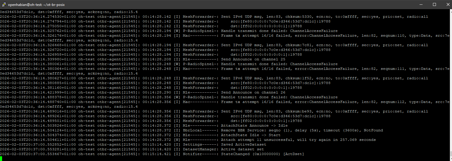

Tip: you can monitor the activity going on while in the yellow state by:
There is really a lot going on, verifying OH/OTBR communication.

In the first post I read:
”…I had to change from the default ch 15 to ch23…”
How can I change the channel? Is it in the Conbee or in OTBR?
Has some installed the otbr as docker?
It’s on the OTBR.
But it depends on your WiFi 2.4GHz and Zigbee situation. Your sweet-channel might differ:
You will need to repair all nodes.
Check with:
omr@shs3:~$ sudo openthread-border-router.ot-ctl dataset active
Active Timestamp: 1
Channel: 23
Channel Mask: 0x07fff800
Ext PAN ID: 4711399112120603
Mesh Local Prefix: fd04:f230:1503:538f::/64
Network Key: ***********************************************
Network Name: OpenThreadGTV7
PAN ID: 0x*****
PSKc: ********************************
Security Policy: 672 onrc 0
Done
I’m currently testing out both Conbees straight on the PC without any USB extension.
Has been stable whole day.
Thanks for your reply!
I have a native installed OTBR on a Raspi 4B running opanhabian 64bit with openHAB 5.1.1. The ConbeeII is flashed with the Thread RPC image. It looks, as if IPv6 is configured well, but I don’t get the dataset in a state to set my system as a leader. From the log I see many ChannelAccesFailures:
Do you have any hints? Should I check my WiFi and Zigbee channels an change the channel for OTBR?
Actually ‘sudo ot-ctl dataset active’ shows this:
openhabian@oh-test:~ $ sudo ot-ctl dataset active
Network Name: OpenThreadGuide
PAN ID: ******
Done
OTBR refuses to start if the dongle is not found, or ip6 is not enabled.
Looks like your problem right now is the Conbee port.
Have a look in the OP where I describe
ll /dev/serial/by-id/
and make sure
sudo snap get openthread-border-router
shows the right radio-url and infra-if, your LAN port on the pi.
Use
sudo snap set openthread-border-router
to change setting as described here: How to set up OpenThread Border Router on Ubuntu - Matter on Ubuntu documentation
