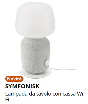

Ikea SYMFONISK (i.e. Sonos) supported?
My wife is pressing me to buy one of this:
It’s a new Ikea lamp with an integrated Sonos speaker…
Anyone knows if it would work with OH ?
It certainly requires a fix to add the new device but it is easy to add if someone is able to provide the expected XML file describing the device.
