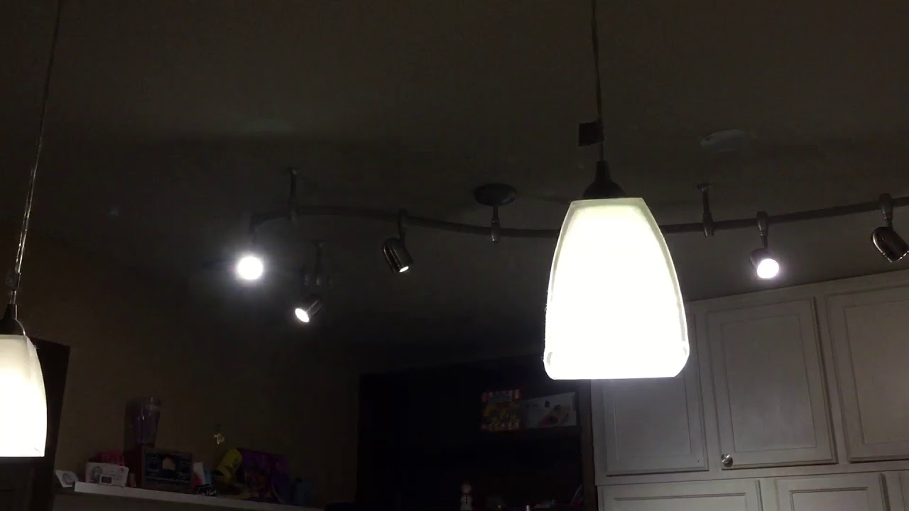

I have my bulbs linked to a hue dimmer on one side the room. I have them tied to an Insteon keypad(slight Insteon delay) on the other.
In the ui I believe it is instant.
Video taken when using my Insteon keypad.
