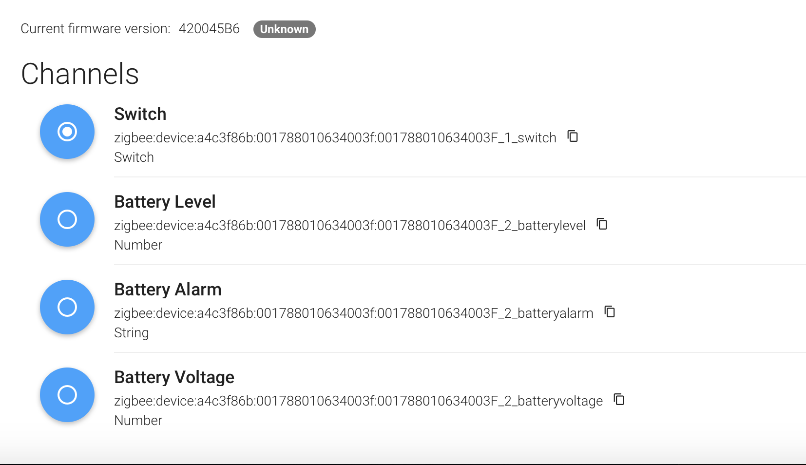

I just tried to connect these remote controls using the Zigbee Binding and had no problems with that. But than I realized I could only find one on/off channel but all the other channels (dimming, switching scenes) are not visible at all. I tried the Hue Switch and both Tradfri remotes but same thing there.
My question now: Is it even possible to bind an Item to these channels or is it just the on/off channel that is visible without using a gateway and just having the Zigbee-binding running?

Only when I try to use the Phillips remote switch or the tradfri remote switch I run in some problems because I cannot see the channels used for the dimming buttons on these switches.
As I mentioned allready I’m using a ZigBee Coordinator with the ZigBee Binding (NOT zigbee2mqtt) and I’m asking now how I can receive data from these dimming buttons on the remote controls.
The buttons for turning on or off are working completely fine only the dimming buttons don’t work. I already checked the log but nothing seems to happen when these buttons are being pressed.

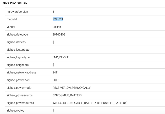

Please can you provide information on exactly what devices you have - eg the properties displayed by PaperUI for each device. And/or providing the XML files for the devices in the userdata/zigbee folder so I can see what these devices are - there are many variants.
I connect to them by using the ZigBee Coordinator CC2531 and this Coordinator is controlled via the ZigBee Binding. I have 3 Phillips Hue LED white, 2 Osram Smart+ (brightness + lighttemperature) and 1 Osram Smart + (brightness + lighttemperature + color). These bulbs are all ZigBee capable and are also Controlled with the ZigBee Binding through the CC2531.

BUT here is my problem: When I tried to add the two switches, PaperUI never discovered channels for the dimming buttons on these remote controls. PaperUI only found channels for the on/off buttons.
