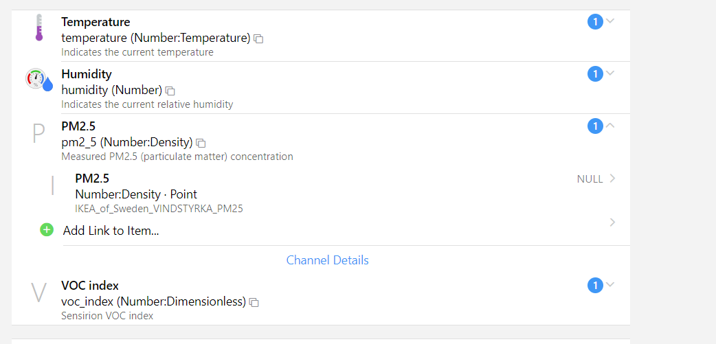

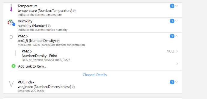

@chris I tried creating a thing file and compiling the binary. I got it to load but the VOC and PM2.5 channels are NULL. Do I need to write new handlers for the new types as well?
Thanks,
Scott
thing file

I think the best way would be to add a “proper” converter for the PM2.5 channel at least. This is a standard zigbee cluster, so it would be good to create it so that this is automatically detected. This should be relatively easy, however the underlying zigbee library doesn’t currently have support for this channel.
Give me a few days and I’ll try and get this added - possibly by the weekend. Obviously I won’t be able to test this, but it seems you’ve mastered the development process, so I’m sure you can pick this up :slight_smile: .
The VOC channel is slightly more problematic since this is not standard. Looking through the binding, there isn’t actually a generic converter that can be used for a user defined attribute. This would be a useful addition, so I will take a look at that as well.
As a matter of interest, where do you define the actual channel types - I don’t see them in the thing file, but they must be defined or they wouldn’t show up in the UI - I guess they are in the channels.xml are they?
